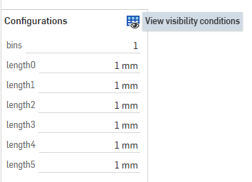

Im making a 3d printed screw sorter. A screw sits on a disc and is rotated by a spinning head, until the end of the screw tips into the right sized hole and falls into a bin below. I want to be able to configure both the number of bins and the screw length of each hole. So I want the user to be able to first use a config variable to set the number of holes, then that number of configuration variables will come up and they can set each one to a specific hole length. Is this possible, is there a better way to do this altogether? Thanks

With configuration visibility conditions, you can make the visibility of Lenght1…5 dependent on the value of bins.
