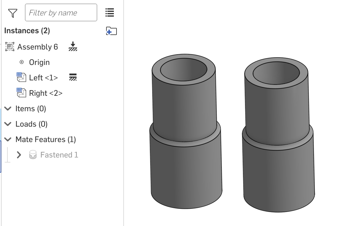

    Your part names are defined in the Part Studio. You can also rename them at the assembly level, by editing the part properties. But, if you have multiple instances of the same part, they will all have the same name. Something like Wheel <1> , Wheel <2> , etc. If each instance had a unique name, that would mess with the accuracy of the Bill of Materials.
  • eric_pesty
    If you want them to be "different" you could add a configuration input to the wheel parts, even if there is no geometry difference it will allow you to make them "independent".
    Depending on what you are trying to do, you could also put each one in a folder and name the folder the way you like.
  • Matt_Shields
    That's a clever solution. This will create unique entries in your BOM, but if you don't care about that, you can configure part names.
