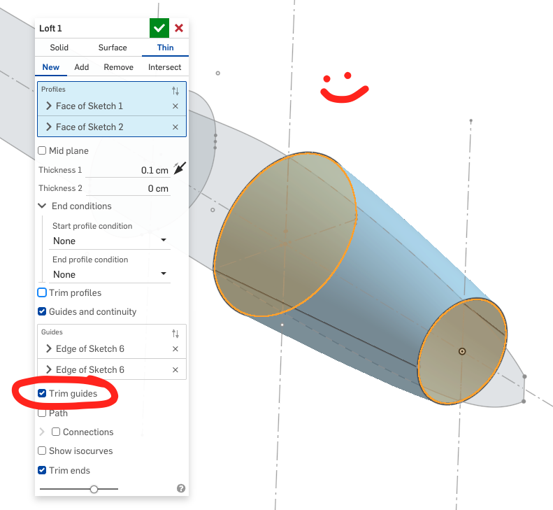

So I'm trying to do this project and I want to create a loft between sketch 1 and 2 with a thickness of 0.1 cm (1 mm) and I need it to follow sketch 6 as a guide line, but I keep getting the error. Can you please help me out?
Link to document: https://cad.onshape.com/documents/d2fa29abe811b0f88b20b1db/w/3a4e91c619c66535e7eba06a/e/ae9da9de42946138083e051f?renderMode=0&uiState=69360558942354211f8eebec
It works fine if you use the
Trim guidesoption. Is this what you intend?-1
Trim guidesoption. Is this what you intend?-1 -
thank you so much, it worked :)
