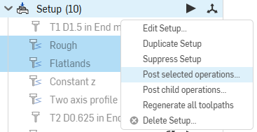

Hello
New to Onshape Cam here. is it me or has the G code post arrow gone missing? How does one now post a created g code/toolpath to download to a flash drive.

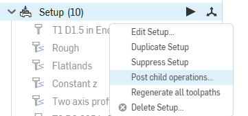

@lee_awad Users can now right click the setup to post. Choose post child operations to post all operations in the setup, or if you have one ore more operations selected, choose post selected operations.
