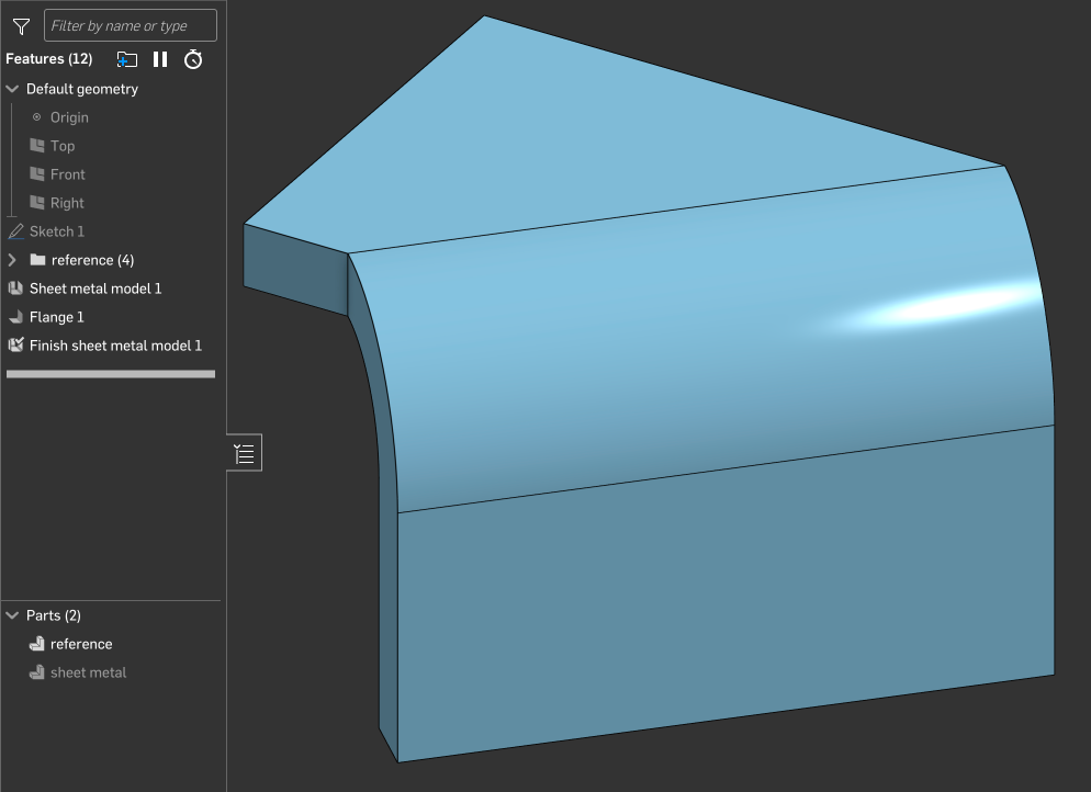

Here's an image of the desired part geometry as a reference:

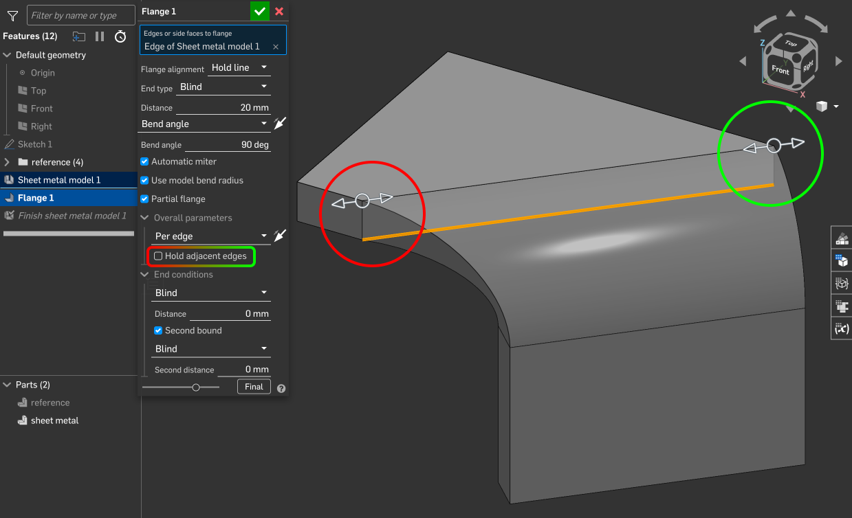

I would like to model this as a sheet metal part, but I'm not sure how to create identical geometry with the flange feature. Here are the existing flange feature details:
It appears that when deselecting "hold adjacent edges", the effect is only applied to the back edge and not the front edge. I would like for both side faces of the flange to be parallel and aligned to the implied perpendicular planes colocated at the ends of the flange edge. How can I modify the flange so that the resulting geometry is identical to the reference part geometry?

    I'm a bit confused. Looks to me that you already have what you're describing except that there is a non flat around the bend. That is the nature of sheet metal because of the normal cut used with most machines to be used. I have seen plasma torch set up with tilt head to cut counter sink on heavier material, but most not.https://cad.onshape.com/documents/7dce41e4fd270f1e6c28b5c0/w/74be216b7bf558a460f0ab0b/e/38e44e0536412f22b9c7ecb7

    It does look like turning off the "hold adjacent edge" only "removes" material (i.e. doesn't add some to fill in the near corner). It looks like what you are looking for is a "bend ends normal to flange" or whatever you would call it….
    While I don't see a way to do this in a single step, this is easily achieved using a "move face" feature:

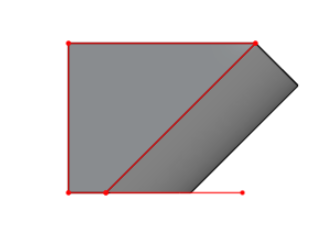

  • eric_pesty

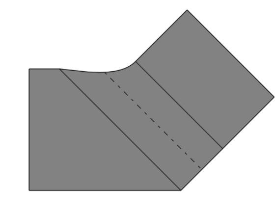

    So it turns out Onshape can be a bit weird with sheet metal corners… The method I showed works fine until about 30deg but doesn't behave properly at 45 where it does this:
    The annoying thing is that it doesn't let you select the bend end face to move it after the fact. One workaround is to "reset" the corner by cutting it out like this:
    Then you can select both the end of the flange and the bend and do the "move face":
    It's a bit of a convoluted workaround, unfortunately we tend to run into these sort of situations once in a while with Onshape. Onshape is generally really predictable but sheet metal is the one area where strange things like this can happen. There's almost always a way to fix it but it can get annoying…
    I'll submit a ticket as this kinda looks like a bug…
