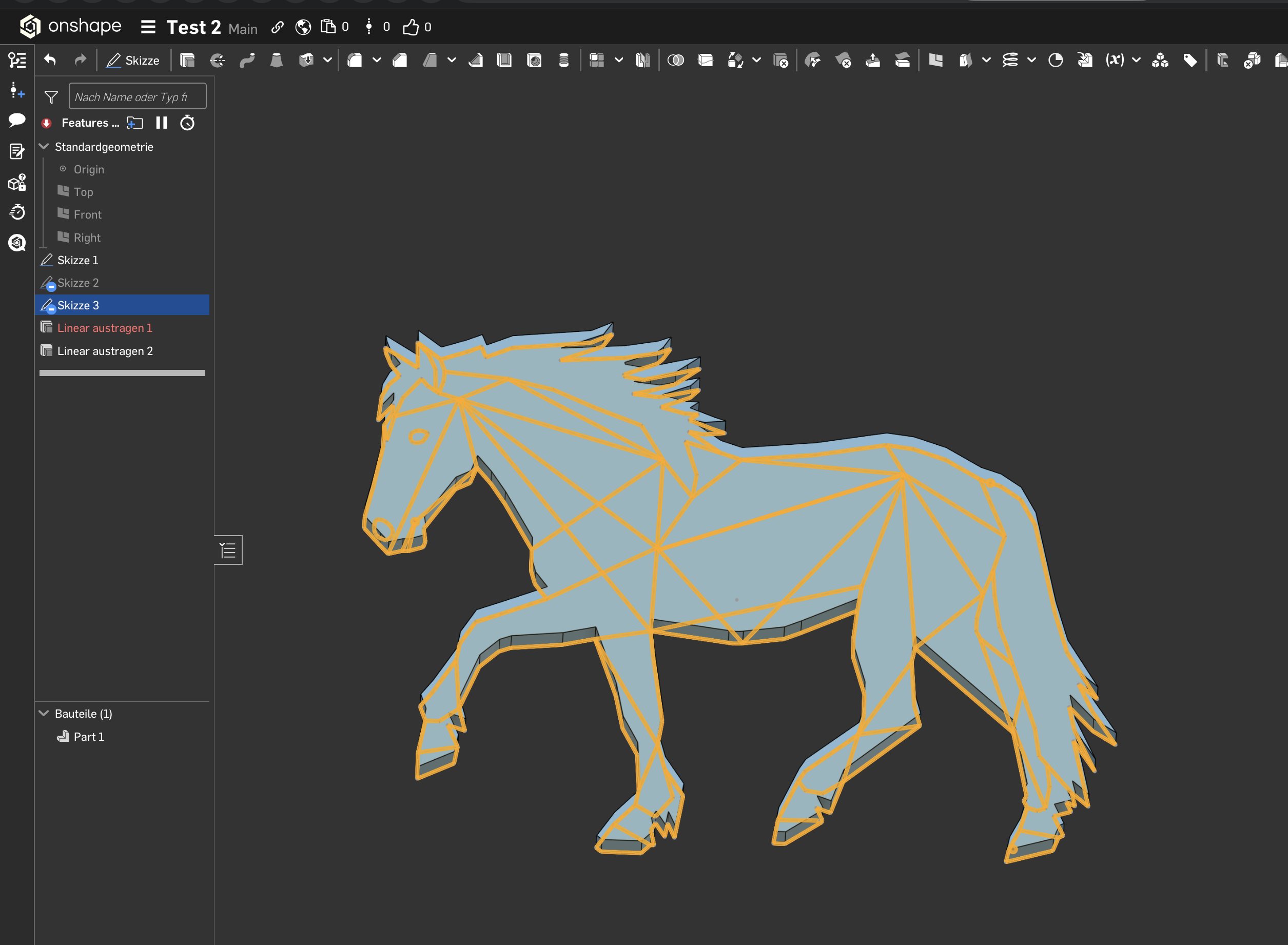

Hey community!
I'm quite new to onshape and 3D-printing.
So far I touched the surface of this awesome application and created some 3D-models based on YT-tutorials and own ideas.
Now I got stucked a bit in using lines with extruded elements. I assume I have to convert a line into an area (e.g. rectangle) to use it properly as a "form" or is there other possibility?
In my case (see attachment) I tried to use lines on an extruded area in order to apply a kind of texture on it.
What is the best way to get such a result?
I appreciate all kind of replies. πŸ™
Thanks in advance! βœŒοΈπŸ‘‘

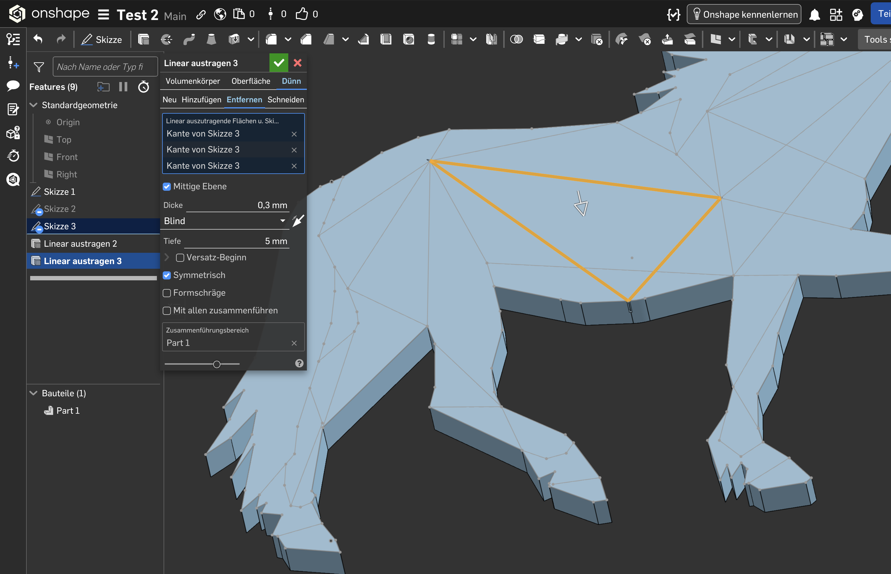

    One step further but not till the end…
    I managed it to find the (right?) tool within LINEAR EXTRUDE + THIN (see screenshot).
    However, it appears that my approach ist only working with 3 lines. If I add more lines I receive an error (red). WHY?
    What can I do to get it in a right way?
  • jelte_steur_info
    depends on what type of texture you'r trying to achieve.
    Do you want to just create thick lines? or raise the whole surface?
    I suspect the algorithm that offsets the lines before extruding may be throwing an error depending on what combination of lines you're selecting.
  • Supercreative
    Supercreative Member Posts: 9 ✭
    I've found a solution (Custom Feature RIB NETWORK). See also my undesired double post:
    https://forum.onshape.com/discussion/29630/beginner-question-how-to-use-lines-along-with-3d-models#latest
  • Supercreative
    Thanks for helping me out.
    I just want to use the drawn lines to extrude these like on the picture above.
    This worked like I want to have it - but only for the three selected lines.
    What can I do?
