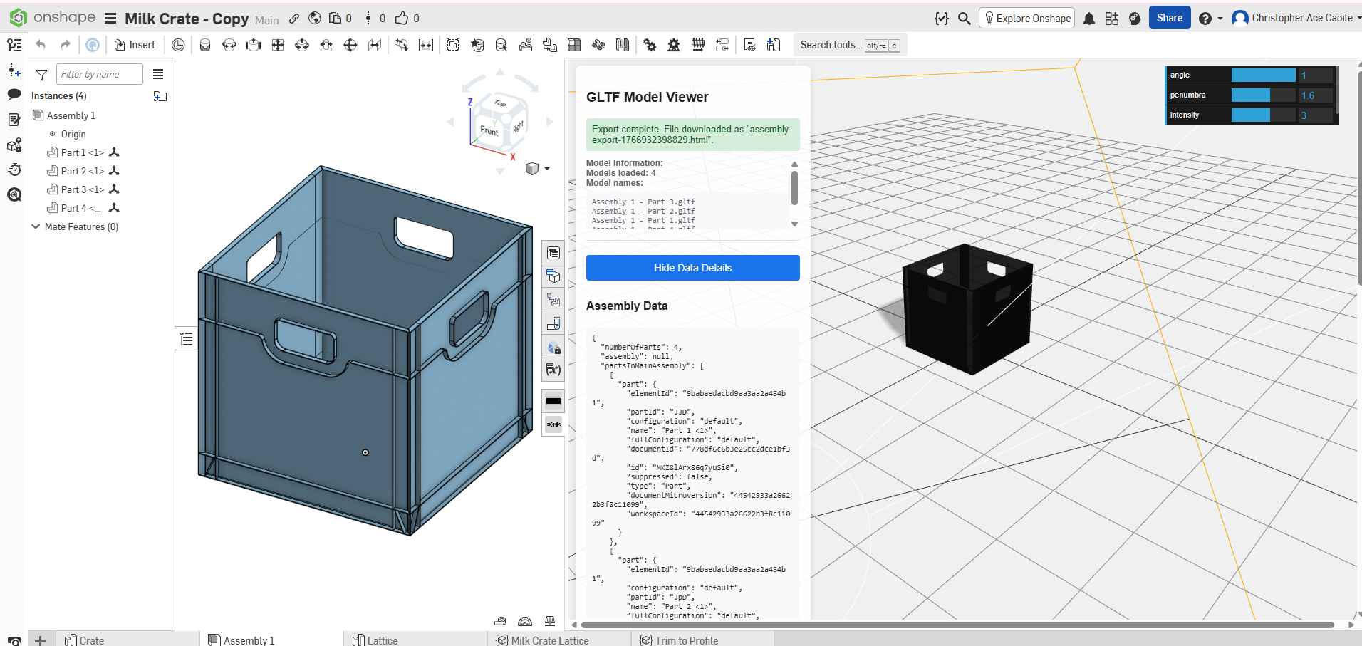

Hi everyone,
Just wanted to share a project I've been working on. It exports an Onshape assembly into a self-contained HTML file.
The extension embeds the GLTF geometry (and in my use case, assembly metadata) directly into the HTML, so it can be opened by anyone, without an Onshape account, and even offline.
It behaves like a lightweight 3D viewer — you can rotate, inspect, and interact with the assembly in a browser, with no external dependencies.
https://www.loom.com/share/a0fa188faead490ea10d43f20a12d888
