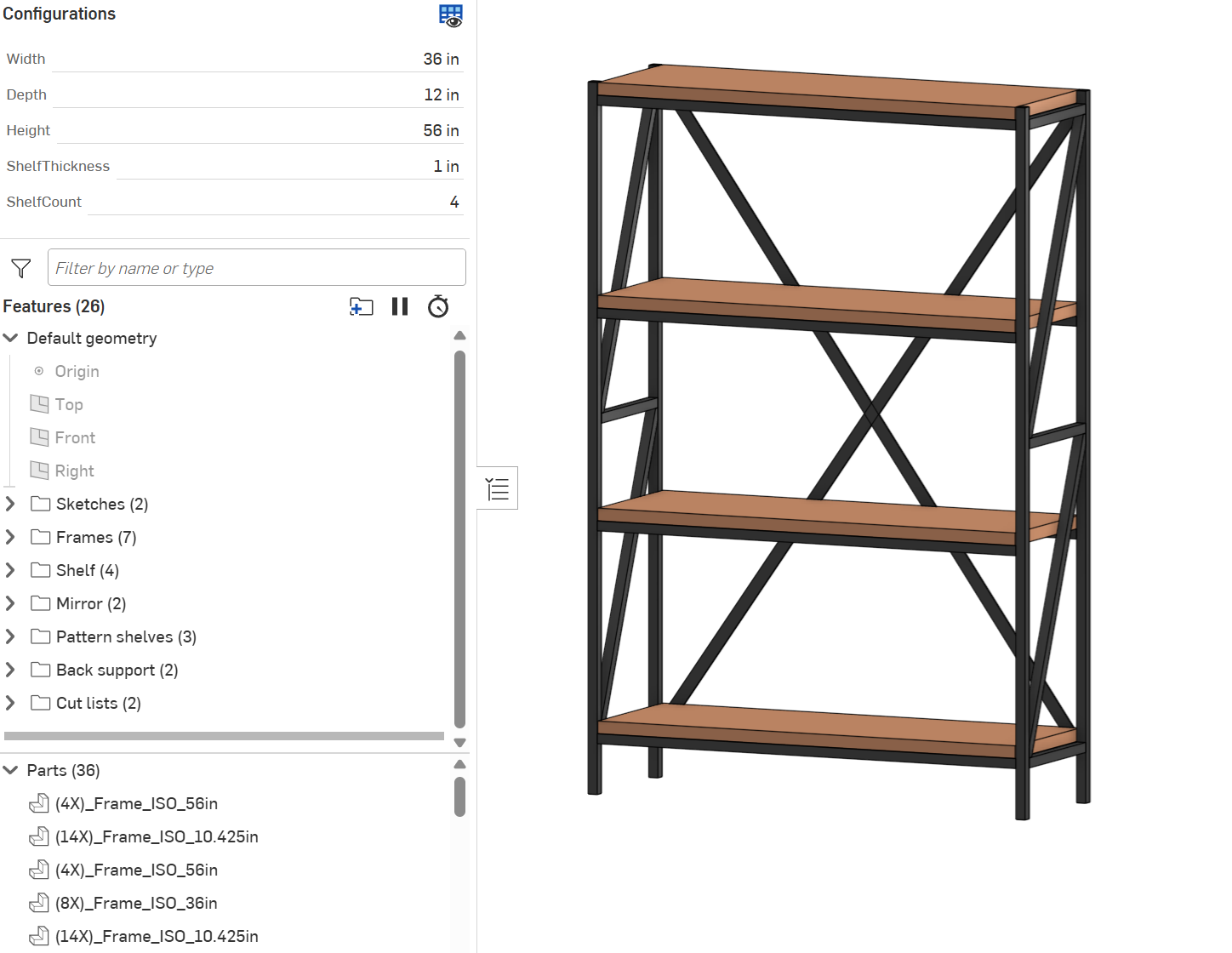

I am drawing a trailer frame and I would like the frame crossmembers to update with the change of the length. I have started to the Variables and Expressions course, but found it was more than I need to know at this time. In other words it was beyond my comprehension for the most part. Just need the basics.
What is your question?
The best way (imo) to become efficient at Onshape is with the Learning Pathways.
Here is an example of how to make a fully parametric and configured frame system:
https://cad.onshape.com/documents/34c10a9878ff5afbb6a65609/w/36db55007701cdd82724516b/e/4813059db….
