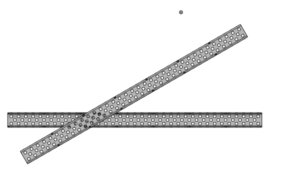

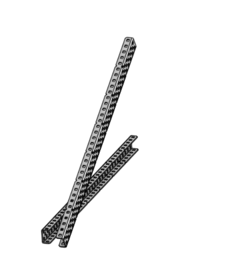

How can I mate two C-channels at a 50-degree angle, as shown in the picture?

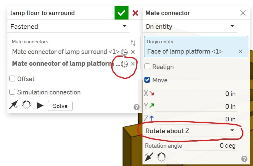

Hello. Mate connectors are very maneuverable. Once you have used a Fasten mate to fasten the two channels together, you can rotate one of the mate connectors to 50 degrees. - Scotty
