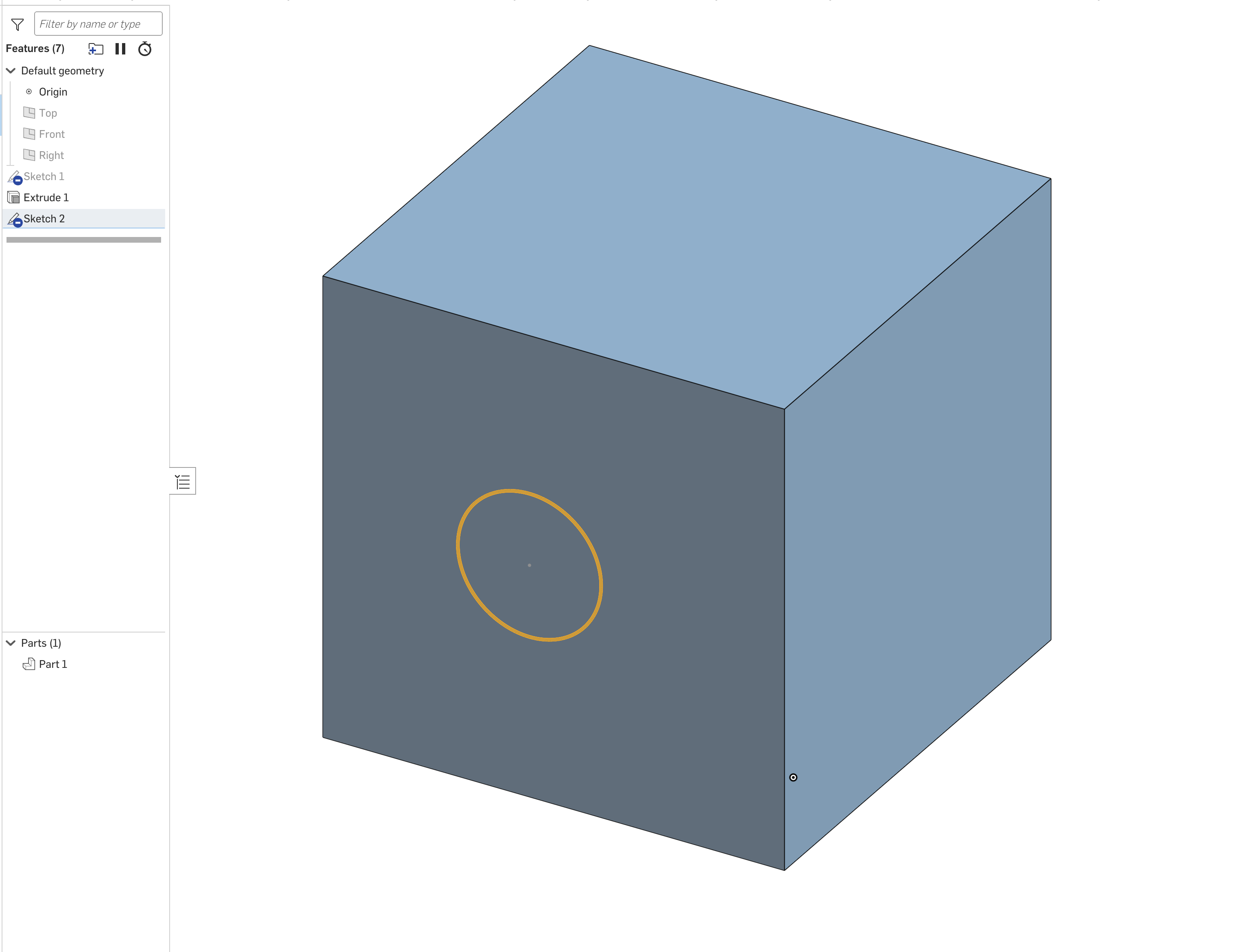

In my use of FeatureScript, I have a fairly common need to do the following: given an edge and a solid object, identify which face of the solid the edge lies on (if any). I'm wondering generally what is the best approach to take for this.
This has come up in several contexts, but to come up with a simplified scenario to better illustrate what I mean: let's say my feature takes Part 1 as an EntityType.BODY input, and the highlighted edge of Sketch 2 as an EntityType.EDGE input. I want to do something to the face of Part 1 on which Sketch 2 lies. What is considered best practice for obtaining a query that selects that face?
  • lana
    You can use evOwnerSketchPlane to get sketchPlane and then selectedBody→qOwnedByBody(EntityType.FACE)->qCoincidesWithPlane(thePlane); to find same plane faces.
