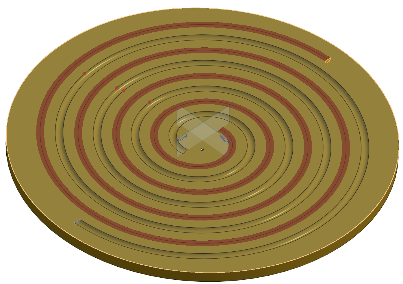

I created two curves using the spiral tool on a revolved surface. The projection of the curve on the surface of my solid worked and I was able to create one sweep. My second sweep shows me some red points tough. I do not understand what they want to tell me and how to find out what I need to create my sweep the way I wanted:
https://cad.onshape.com/documents/5b9a86f89358ce0c1fd4c0da/w/6424e55940d61dc268989305/e/8f2c87ea66517a94e76364ac
what am I missing? Why is the second sweep not exactly like the first one?

    Not sure why, but if you make the halfpipe 2 sketch a full circle, rather than a half circle, it works.
  • martin_kopplow
    @richard_theodor These grooves are meant to be identical, right? Make one and rotate-pattern the other. Then, the second will automatically be the same as the first one. ;0)

    this is how I actually solved it. But what am I missing here? Why is this not working the way I think it should?
