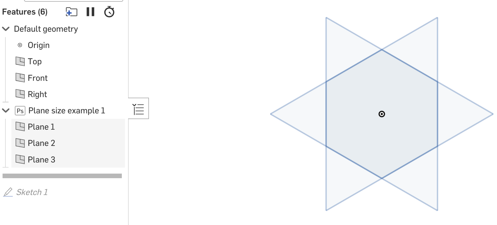

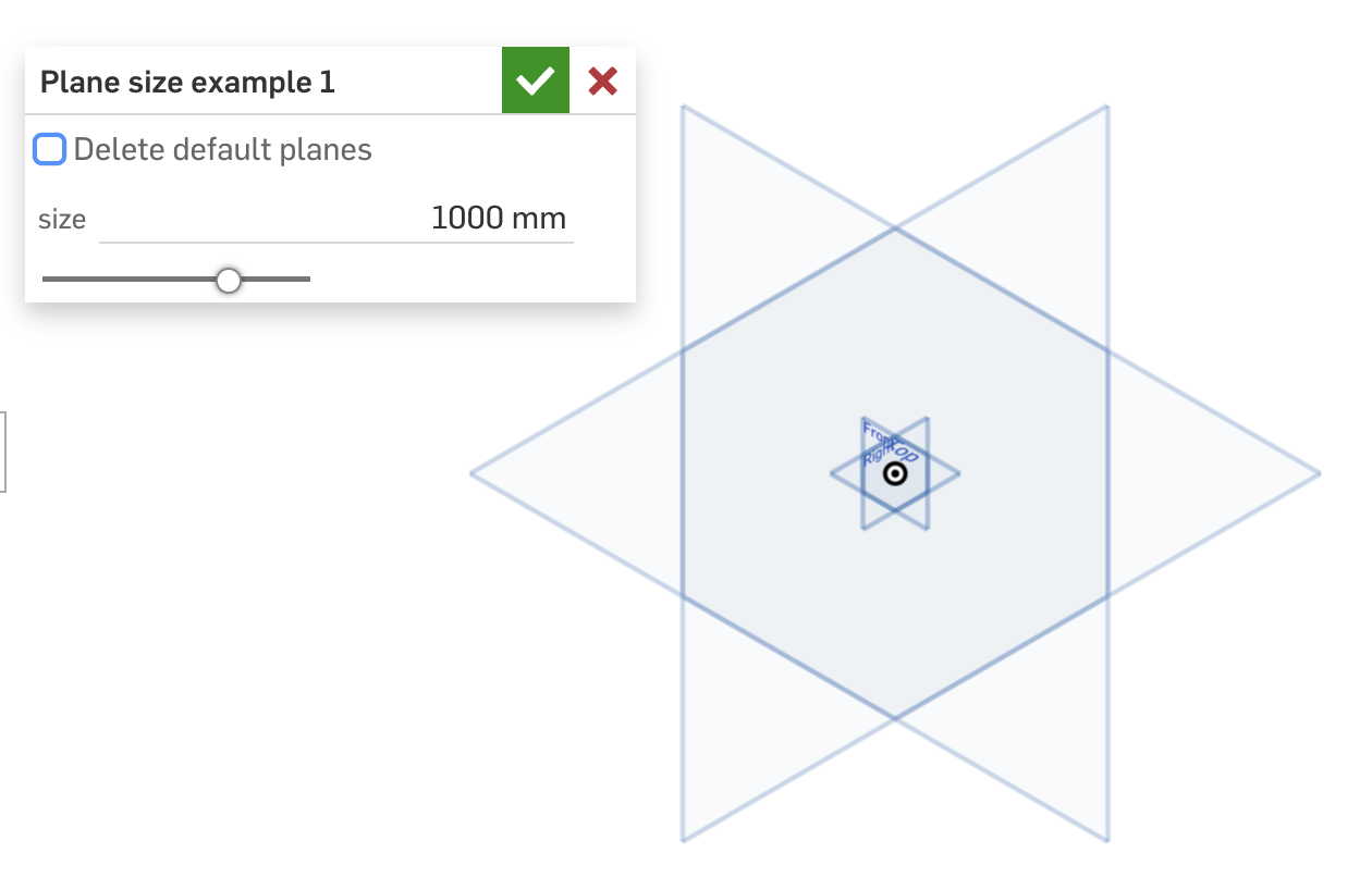

  • jnewth
    You can only manually adjust the default planes. You can, however, create planes at whatever size you want via FeatureScript.
    In FeatureScript you can also delete the primary plane bodies (almost certainly a terrible idea). The "Top, Right, Front" entries stay in the feature tree but clicking on them doesn't do anything.
    Put it together and you get this:
    https://cad.onshape.com/documents/97202190e6c4ac264a407adb/w/5a5ef0b66a6c0e87b41ce035/e/c0951767de310d50afc2d7bb
