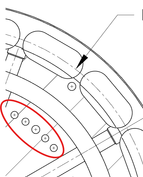

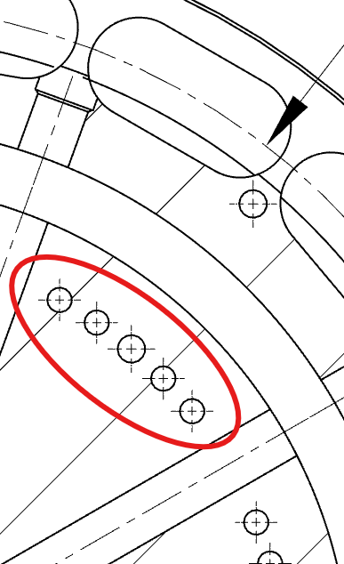

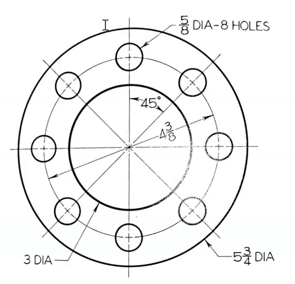

Is there a way to completely get rid of the hole center marks that come in with view. I tried the drawing properties "Extended lines" but it still leaves the annoying mark in the center. I am trying to make clean bolt hole circles like the ones in Solid Work (last pic. below).

    Right-click the view (not the lines) → show/hide → hide auto centermarks.
  • PeteYodis
    PeteYodis Moderator, Onshape Employees Posts: 594 image
    @Carlos_natal A few things here. You actually don't need to hide them first. You can just create manual ones as you want using the manual centermark tool in drawings and we'll basically convert them to what you want without first needing to hide them.
    Secondly, if you modeled these holes with a circular pattern in the part studio, we can automatically create the circular pattern marks as well.
