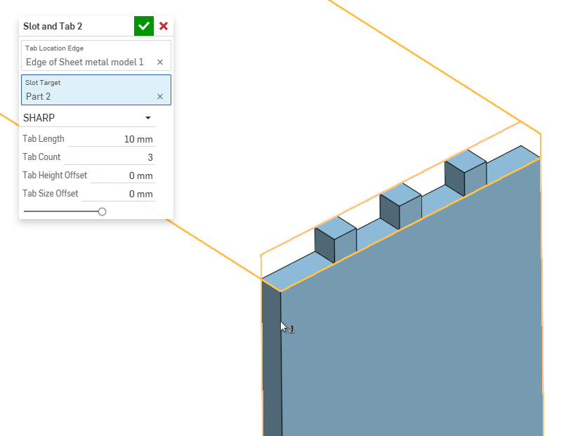

Hi Everyone,
I want to be able to just add this type of paint tab onto sheet metal parts while they are still active with just clicking an edge.
even better if you could select the amount of tabs you want spaced per edge?
is it possible because adding paint tabs to an edge is very frustrating when there are many sheets in 1 studio.
  • Caden_ArmstrongCaden_Armstrong Member Posts: 407 PRO
    It can be done with a featurescript. I've made a few different featurescripts for placing tabs (and slots) on sheet metal.
    The nice thing about a custom feature is that you can bake the tab sketch into the feature so that you don't need to redraw the sketch (or derive it) constantly.
    Heres a really simple example that just does square tabs.
