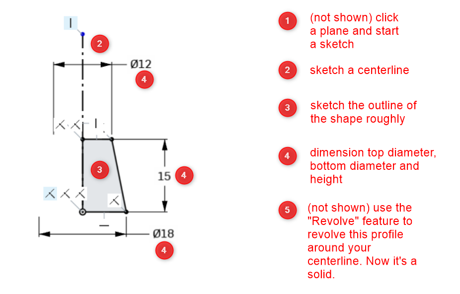

    For this I like the Revolve feature. (The grey shape in Scotty's example above).
    Step 1: Select a plane and start a sketch.
    Step 2: Sketch a line and change it to a "Construction line".
    Step 3: Sketch the profile of your shape, roughly. It needs to be on this Construction line.
    Step 4: Dimension the two diameters and height. Clicking the top right point, then the Construction line, then moving the mouse to the left of the Construction line creates a diameter dimension. (In the pic shown below).

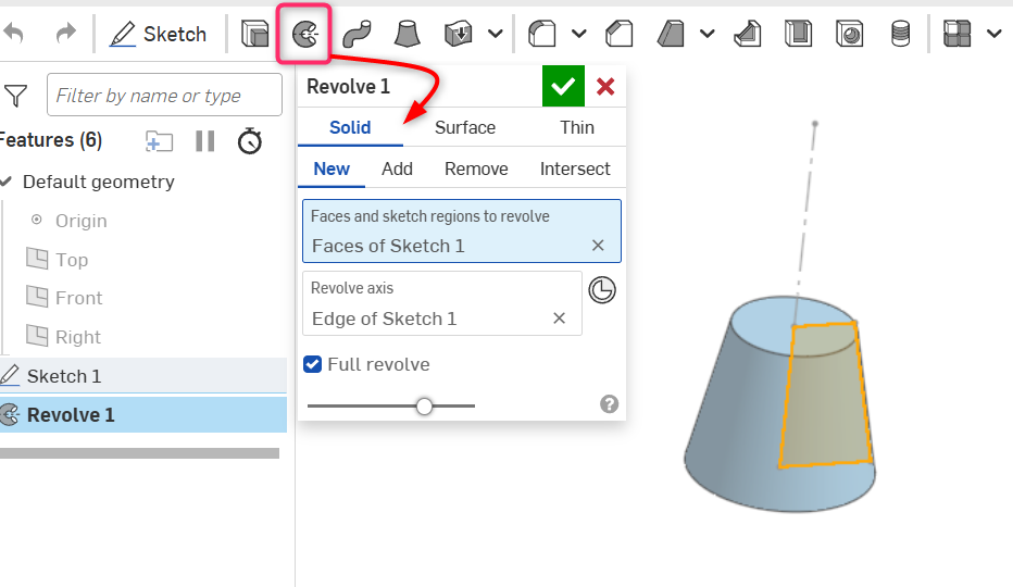

    Step 5: Use the Revolve feature. Select the Construction line as the "Revolve axis". Tick the "Full revolve" box for it to revolve 360 degrees.
    Then if you need add more material to or take it away from this shape, you can either modify this first sketch and the cone will update, or you could repeat this process again.
