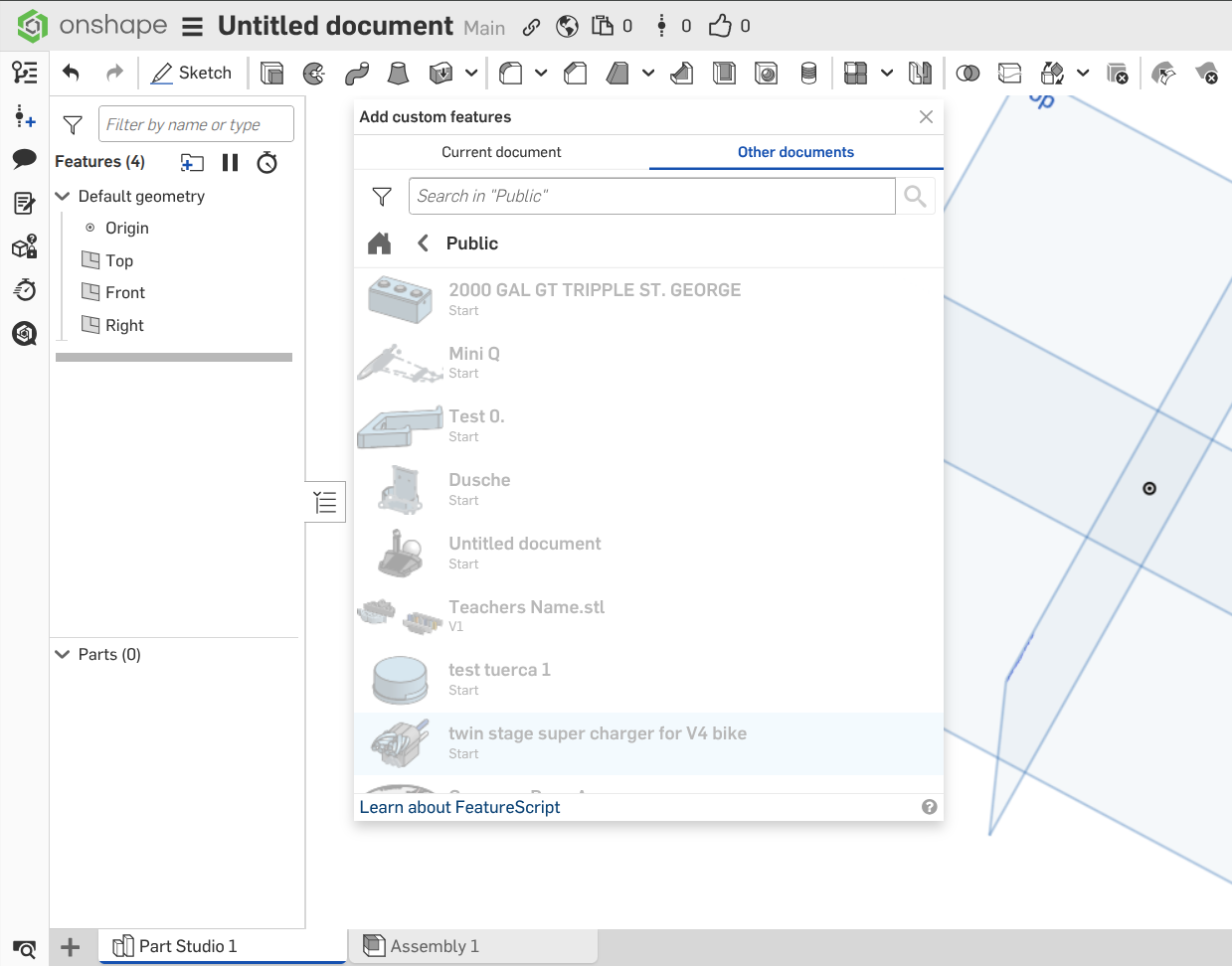

Why are most entries greyed-out in the 'Public' section of the Custom FS library?
CADNurdCADNurd Member Posts: 46
edited January 26 in FeatureScript
Just curious. Is it just me, or does everyone else see the same thing? [see below]

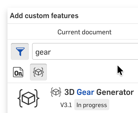

    They don't contain Feature Studios. So why are they there? No idea. You need a search term and a filter:

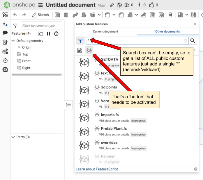

    @NeilCooke - I suppose that filter should really be on by default.
    So, to get a list of ALL public Custom Features, do as below . . .

    For "official" custom features (not copies) there is a mechanism to "publish" them. These published features can then be found by adding the "Published FeatureScript" criteria in the advanced search:
  • CADNurdCADNurd Member Posts: 46
    @NeilCooke - Thanks. Found that eventually - though I had to hunt for a while - in the search options on the main dashboard outside of any document.
    And I see that's a fairly recent update - but definitely a step in the right direction . . .
