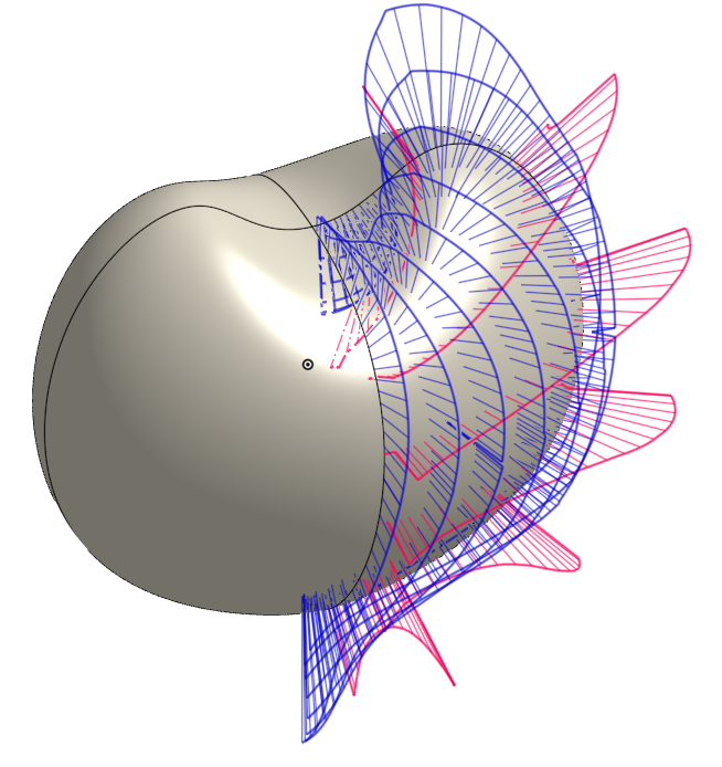

I'm trying to create a single shape - but one with complex curves:
A 'rounded heart' shape.
I believe the construction should be relatively straightforward, as the object is symmetrical front/back and left/right
I believe the intended way to create such an object is:
* Sketch the silhouette of 1/4th of the object from front, top, and side
* Use loft + guide to form a surface defining this 1/4th
* Use mirror/fill to flesh out the rest of the symmetrical object
The sketches that describe the silhouettes all use splines to try to enforce tangency by the mirror planes, while also constructing the smooth curves
However, no matter what I try, I cannot seem to get tangency between the faces.
(Tangency is desirable, as I am later going to be performing complex intersection/split/thicken operations on the faces, and thus want them to be a 'single continuous curved surface' and not 'four separate faces')

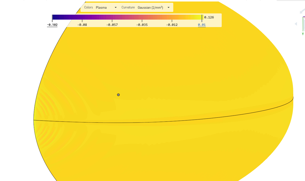

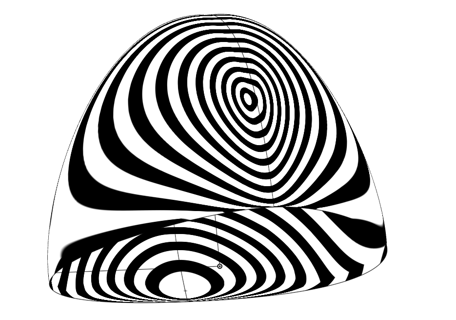

What am I missing here? Do I misunderstand something about tangency? I'll be honest - I can flick on all the curve diagnostic tools, but I fail to see what how they would direct me to a solution here.

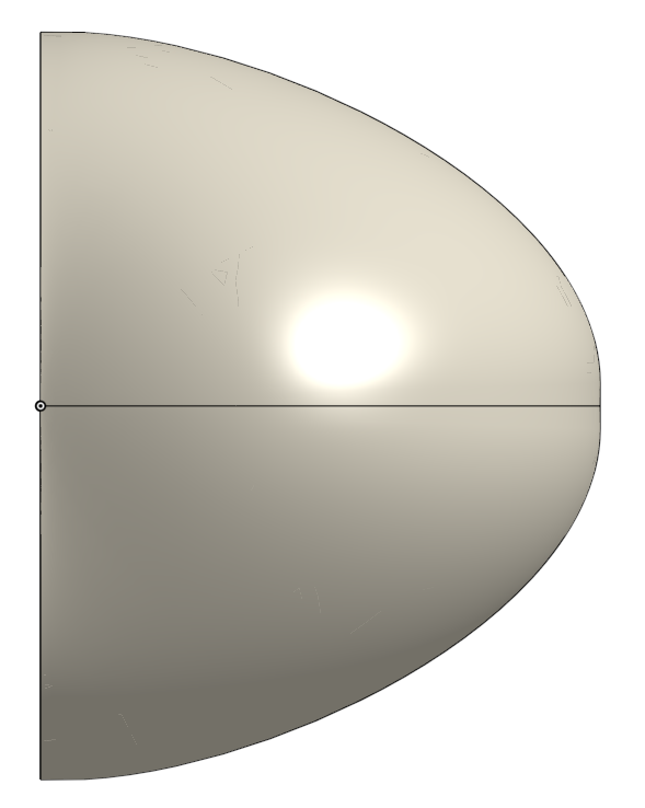

Check out my example heart here

If I understand the model right, you already had tangency, but you wanted merging of all faces into one. See Heart No.2 for at least a partly seamless surface.
It might help with tangency if the start and end condition of your Loft was "Normal to Profile". Also, the constraints between the sketches were a bit shaky, but I don't think they were part of the problem. (BTW.: Your original tree could be shorter: Fill isn't needed, and the mirrors could be combined.)
I doubt OS could create a fully closed periodic surface, though.
