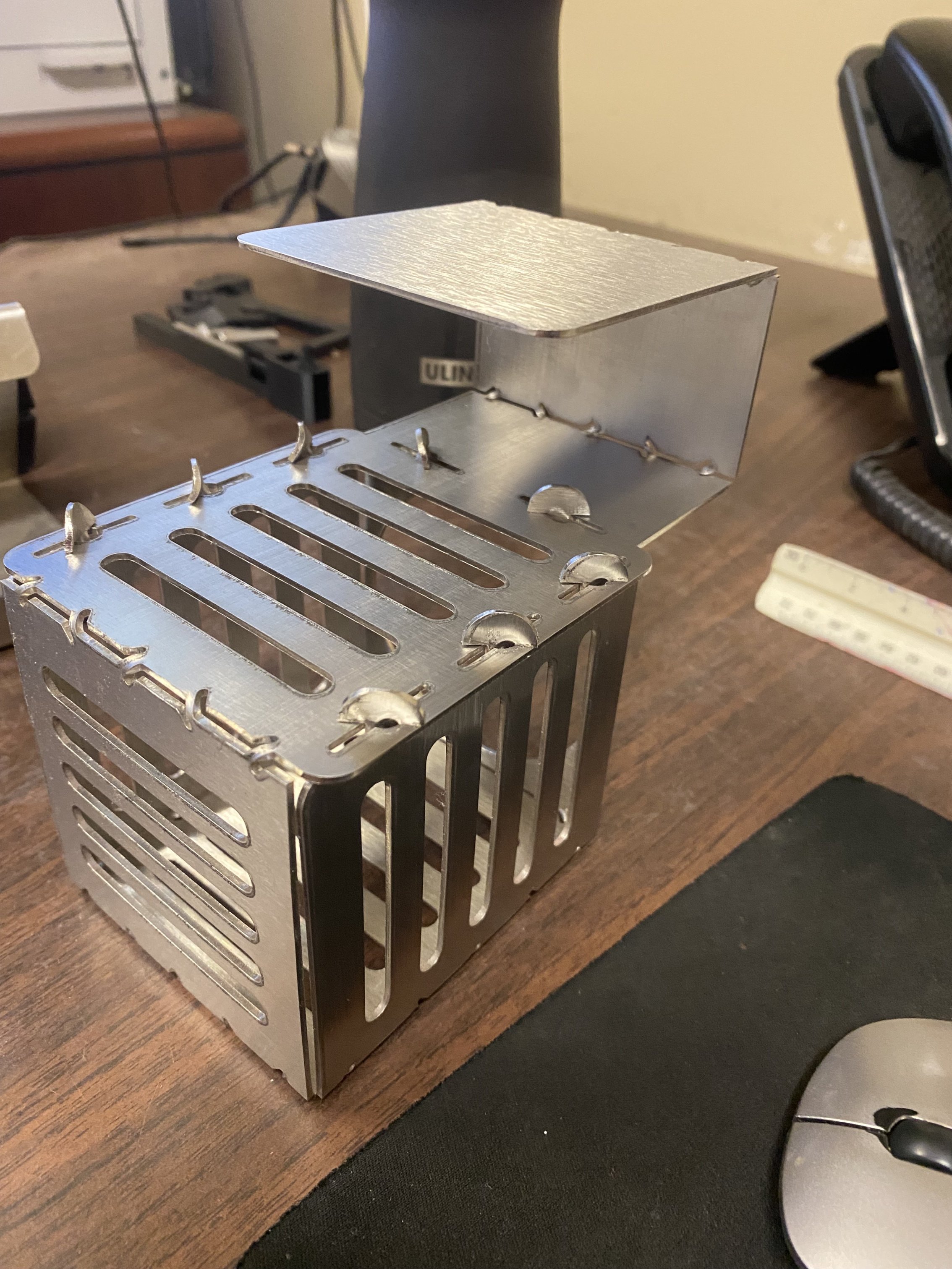

@Derek_Van_Allen_BD could you make the tabs angled to give it a stitched look when hand bending? Here is an example I did.

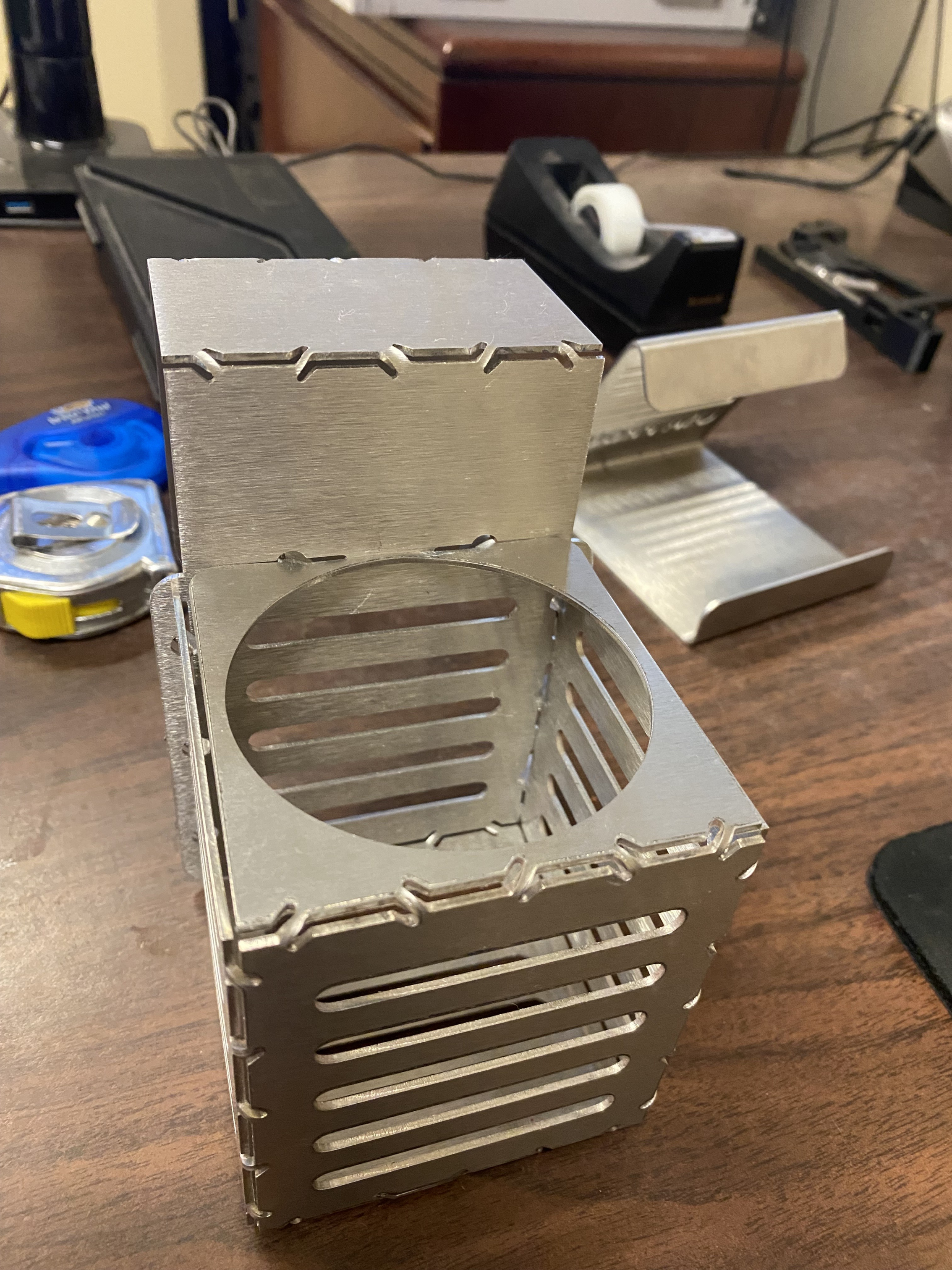

Would it be possible to have tabs as shown below that are twisted to lock in hand bent parts
3 -
That geometry is probably incompatible with the way I'm developing this feature unless I get really clever about how to make those boolean tools. Twist tabs would be a different feature I'm interested in developing but that will require updates to how one of the sheet metal utilities functions for me to be able to get the twist to be represented without doing a Finish Sheet Metal as part of the operation. If I get the ability to substitute one tool body for a different tool body in the flat we could get there but there's not currently a mechanism for that.
