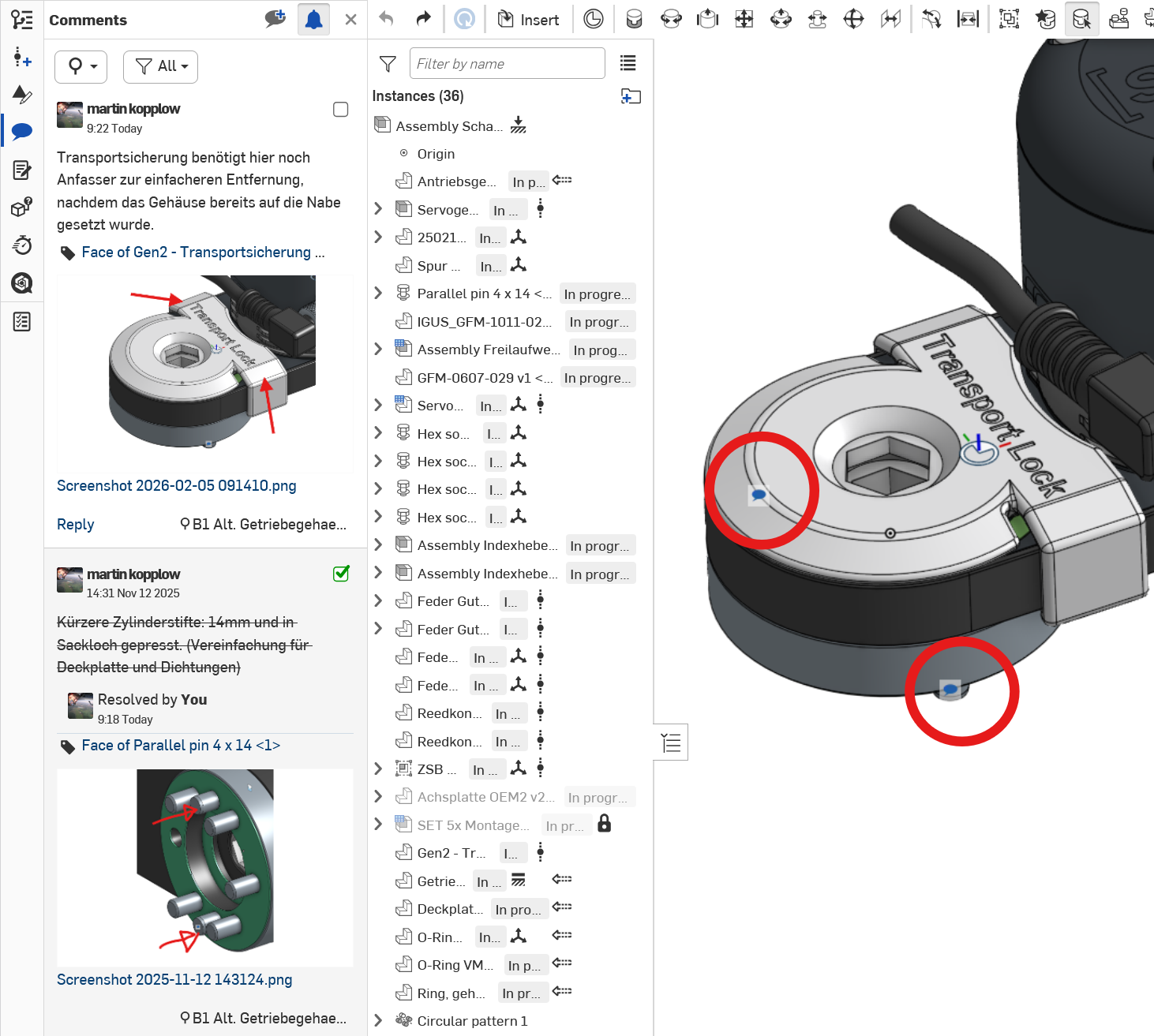

  • martin_kopplow
    What about comments on the part studio level for part treatment, and on assembly level for mounting instructions? These will then show up as little clickable icons in the 3D model.

    Domechanic Member, pcbaevp Posts: 17 PRO
    For me, that would only be a temporary solution.
    I would be afraid that it would quickly become confusing.
    If I could filter the comments by “assembly tab,” it would certainly be better.
