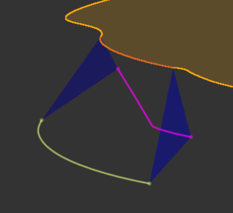

I am trying to do an opLoft, and it fails, giving me the following error:
@opLoft : LOFT_SELECT_GUIDES
I am initializing the loft in the following way:
opFitSpline(context, id + ("outSpline" ~ edgeId ~ "Face" ~ faceId), {
"points" : outPts
opFitSpline(context, id + ("inSpline" ~ edgeId ~ "Face" ~ faceId), {
"points" : inPts
opLoft(context, id + ("ellipseLoft" ~ edgeId ~ "Face" ~ faceId), {
"profileSubqueries" : [ qSketchRegion(id + ("startSketch" ~ edgeId ~ "Face" ~ faceId)), qSketchRegion(id + ("endSketch" ~ edgeId ~ "Face" ~ faceId)) ],
"guideSubqueries" : [qCreatedBy(id + ("outSpline" ~ edgeId ~ "Face" ~ faceId)), qCreatedBy(id + ("inSpline" ~ edgeId ~ "Face" ~ faceId)), faceEdge]
I have done the loft manually (manually selecting all 3 edges that the opLoft would use) and it works
Thanks in advance

    What @S1mon is correctly pointing out is that you should verify that all of your queries, e.g.
    and
    faceEdge
    actually exist, are of the right type, and follow the rules (Each guide curve should intersect each profile once.)
    Using the Report feature is a great way to do so….

    I can confirm that they all exist and that the types are correct:
    Sketch region 1 { featureId : [ FgBIysKu6rXgK3O_0 , startSketch2Face0 ] , filterInnerLoops : false , queryType : SKETCH_REGION }
    is type FACE 1
    Sketch region 2 { featureId : [ FgBIysKu6rXgK3O_0 , endSketch2Face0 ] , filterInnerLoops : false , queryType : SKETCH_REGION }
    is type FACE 1
    Out Spline { featureId : [ FgBIysKu6rXgK3O_0 , outSpline2Face0 ] , queryType : CREATED_BY }
    is type EDGE 1
    In Spline { featureId : [ FgBIysKu6rXgK3O_0 , inSpline2Face0 ] , queryType : CREATED_BY }
    is type EDGE 1
    Face Edge { queryType : TRANSIENT , transientId : JGJ }
    is type EDGE 1
    Also, I'm pretty sure that the points are coincident on the sketch plane because I defined them as such:
    skPolyline(startSketch, "polyline1", {
    "points" : [
    vector( 0, 0) * inch,
    worldToPlane(startSketchPlane, inPts[0]),
    worldToPlane(startSketchPlane, outPts[0]),
    vector(0, 0) * inch
    I guess there is a chance that the spline points (outPts[0] and inPts[0]) are not actually on the plane and are just being projected onto the plane? That being said, visually it looks correct, and again, when doing a loft manually with those selected edges, it works. I'll keep working at it. Let me know if anyone else has any ideas.
    Thanks again

    Are you trimming the guides/profiles? In the regular feature I believe it defaults to doing that.
