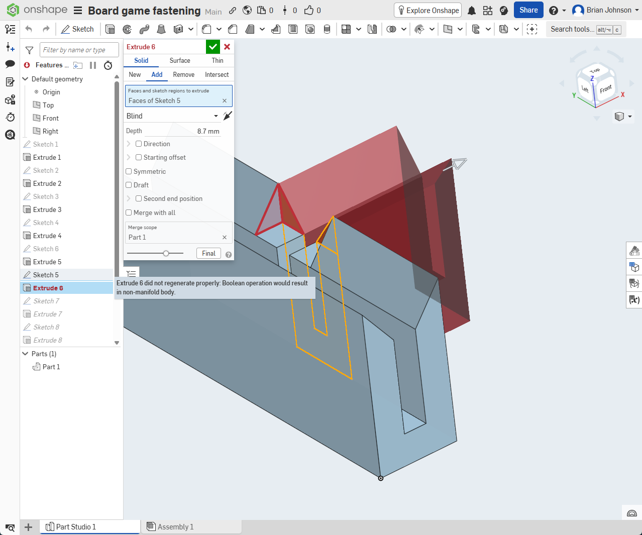

Hello, I am running into a "Extrude did not regenerate properly: Boolean operation would result in non-manifold body." issue, whatever that means. It's driving me crazy, I don't understand what the issue is. It seems that the problem is related to the triangle at the top. There is a "Loft" in that area, which for some reason is not seen here, so it should theoretically work (I thought). What exactly is the problem, and how can I solve it? Thanks!
I know I could solve this by adding another part, but I want to have one part.

    the two hightlighted triangles only touch each other on a line in the corner. The parasolid kernel doesn't like this. so either give it some overlap or some clearance or make it as a separate part and unite them later when there are surfaces touching rather than only lines or vertices.

    Alright, thanks, I was able to do it when extruding a new part and then using boolean on them. Not the ideal solution but gets the job done. May I ask why it "doesn't like" when two solids only touch each other on a line? Feels like a pretty common and completely valid situation to me.
  • bladecbladec Member Posts: 35 PRO
    Because non-manifold geometry can't exist physically in the real world. If Onshape allowed non-manifold bodies then you'd want/have to fix them before exporting for production anyways. Might as well disallow them and require users to address the non-manifold issues early.
