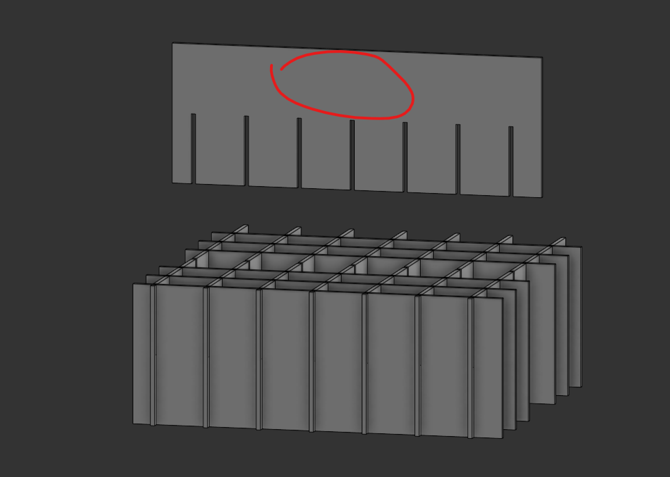

A common request from my team is the want for a script that automatically generates part names or numbers and etches / engraves the text into the surface of the part somewhere so that our fabrication team gets easier puzzles to put together and the drafting team gets to spend less time writing puzzle solving instructions. The text generation side of featurescript has plenty of examples to work from, as well as property and attribute handling if I wanted to label things based on part names or variables, but the automatic placement of that text onto valid locations of a part's face without dropping the text into the infinite void of the boomerang shaped splines we like to draw is a lot less trivial. I know this can be solved with a largest inscribed circle or pole of inaccessibility calculation to find the biggest candidate spot to drop a label but I'm looking for something more performant than an iterative solver method to apply to part studios that have 100+ parts that all need their own labels. I could do a net of possible grid locations with some search resolution but I've got long skinny bendy parts that will for sure miss every grid point unless the resolution is set needlessly high.
Anyone else ever make an attempt at tackling this problem or a similar one that has an example to share?

    Well, what if just put the text on the largest face, optionally planar, in the point with internal coordinates of (0.5, 0.5)? Or aligned along largest edge in its center on the side of largest face?
  • Derek_Van_Allen_BD
    Derek_Van_Allen_BD Member Posts: 1,165 PRO
    @Konst_Sh (0.5, 0.5) ends up being in the void on horseshoe shaped parts. Searching along the largest edge could be a viable strategy for some parts but the middle of that edge is likely to end up corresponding to other important geometry on the opposite side of the perimeter like slots in a cross bracing piece.
    I guess I could choose longest edge and search a couple of samples on that, which would be faster than a full grid approach.

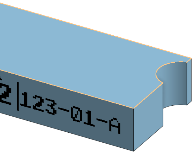

    One of the challenges with this is that FS can't read properties (it can set, but not read, nor overwrite). It can read/write attributes. Part numbers are properties. So if you want to create geometry that is driven by part number, you would probably have to manually enter it in to a "part number writing script".
    We ended up creating a numbering convention for our printed studs (we are automating wood framing for housing). These studs are all programmatically generated, so the part number can be written to the property and also as an attribute, where I can later retrieve it in FS. The net effect (along with some funky-not-recommended decal trickery) gets us this:
    So: Maybe write the script to apply an identifying number in series ("1", "2", …) but this will be hard to force it to match the part number property without manual modeling intervention. If other people have figured out how to get around this limitation I'd love to know about it.
