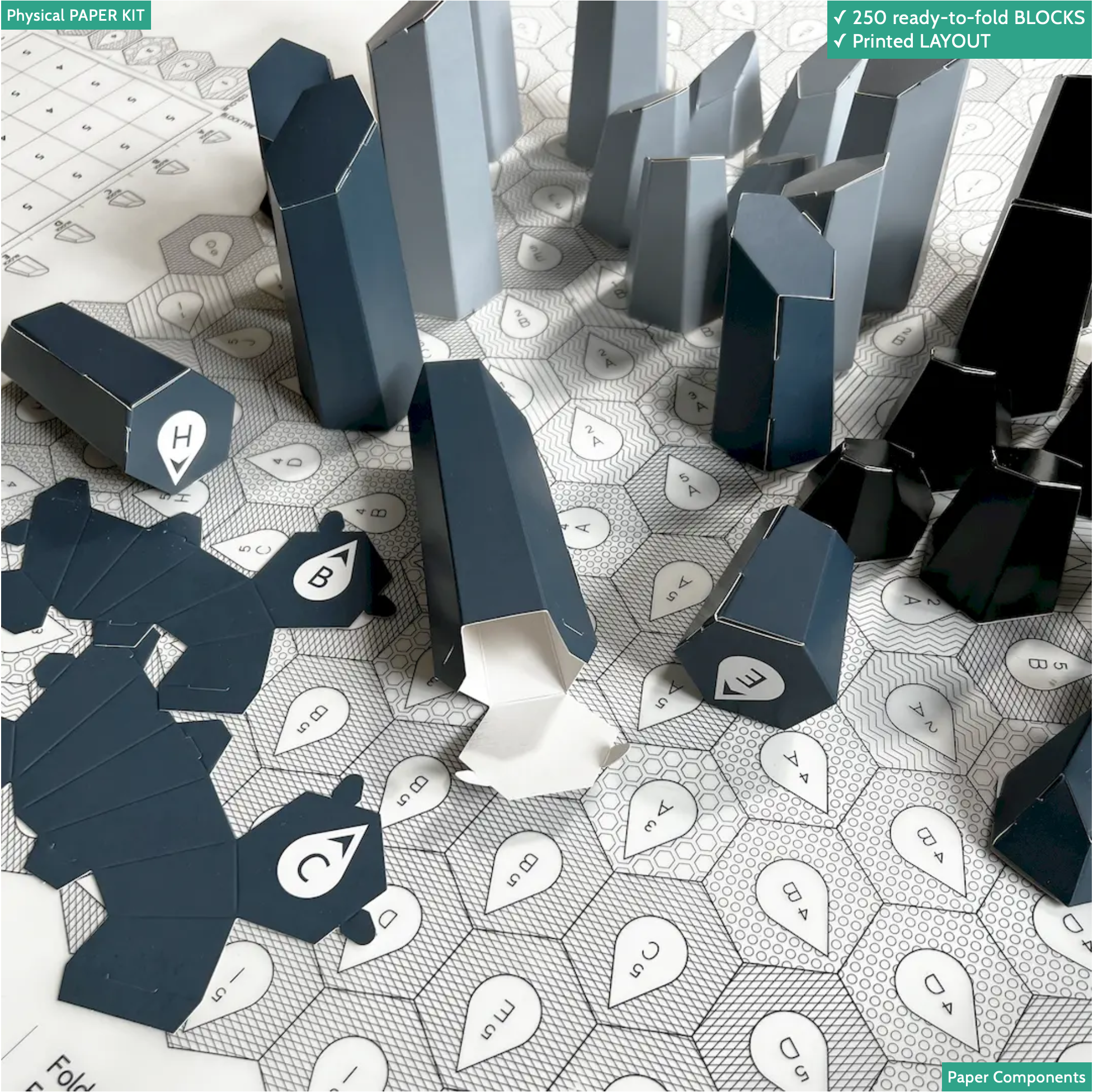

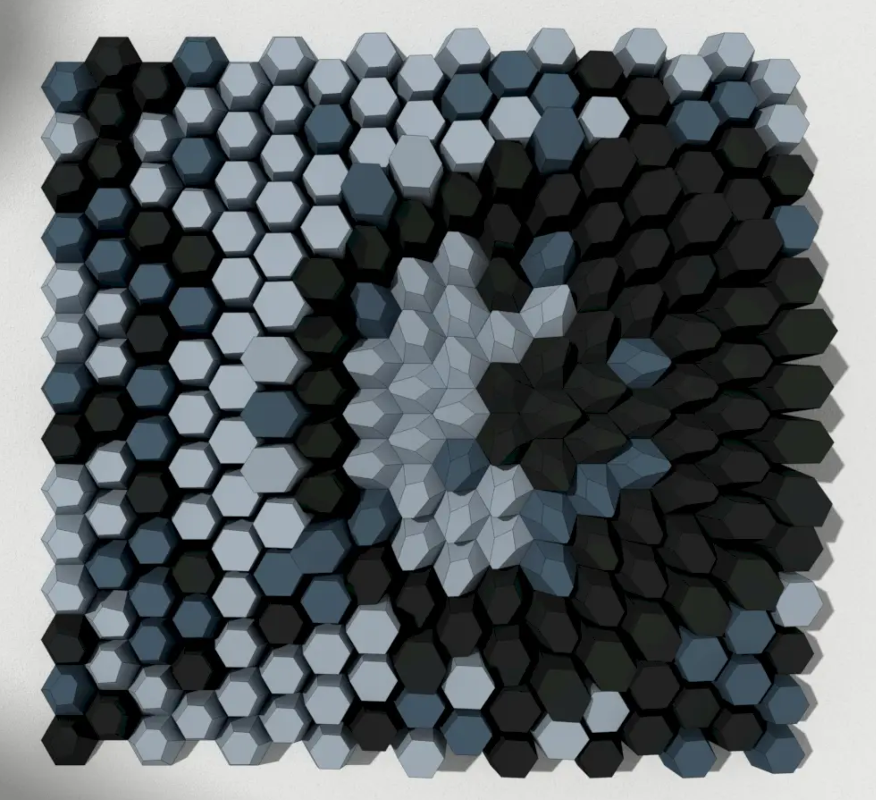

    S1mon Member Posts: 4,637 PRO
    Somehow this is reminding me of this thing that I saw recently:
    https://www.paragami.com
    From the illustrations on the site, I assume that they use Rhino/Grasshopper to automate these, but I could see doing something like this with Onshape, attractor patterns, query variables/patterns, and sheetmetal.
