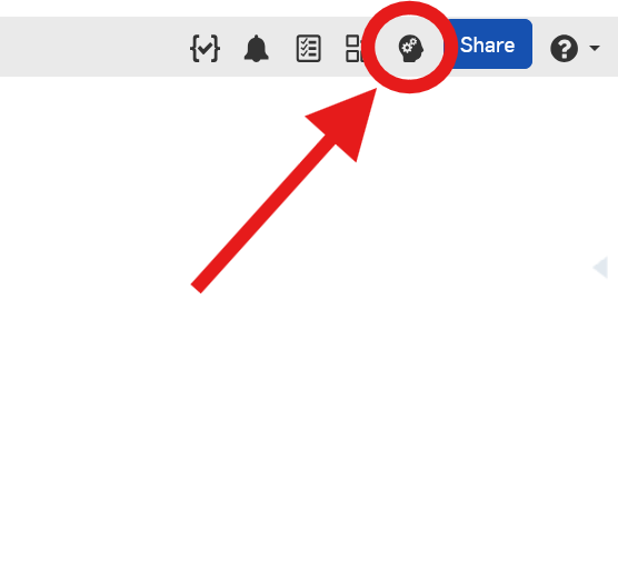

    You may want to go though the Lessons in the Learning Sections to get a good start in Onshape. Klick on the Gearhead icon in the top right corner of he Onshape window:
