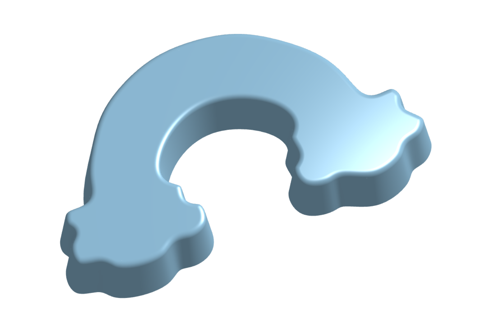

Hi, I'm very, very new to CAD. I'm a chocolate maker trying to design my own tools for vacuum formed chocolate molds.
Right now, I'm struggling to add draft angles to my shapes. I finally figured out how to import the image, trace it and extrude it, but following the advice from the AI (to copy the sketch, enlarge it and then use the loft tool to combine them) isn't working for me because I don't know how to "move" the second sketch.
Here is my link: https://cad.onshape.com/documents/c3a8fa24f076e815b4e1b544/w/0ed8d457696eb2e6adf14cff/e/f79bc843fc5e0b4b84b3ba9c?renderMode=0&uiState=6993c3bd25f9cfcd8cb1e887
Size is not hugely important because I can mess with the dimensions later in my slicing software, but I'm ultimately planning to print it at 11 mm thick. I need a fairly obvious draft angle to get my molds to release. The success that I had so far was with a 7 degree draft angle. I can't get my current shape to extrude any greater than a 3 degree angle (and I spent about eleven million years 3D printing them, only to have them stick in the mold.
Thank you for any help you may be able to offer. (These are destined to be white chocolate filled with cereal milk ganache and lucky charms marshmallows).

    what AI advised you that? did you use the onshape ai adviser that is built in? that may give you more accurate advise.
    did you try the 'draft' checkmark in the extrude feature? it's not working on your sketch though because it's created from one spline and it doesn't know how to deal with the sharp valleys in the clouds.
    So in this example, the cloud valleys are left sharp by using a bunch of separate splines in the clouds connected to true arcs for the rainbow.
    then extrude with a draft, and you can possibly apply a fillet afterwards.:
    https://cad.onshape.com/documents/52fbfcce9f79c7643c939789/w/4fbe03a7a59b8061e63e55aa/e/444077152161c0241939b674?renderMode=0&tangentEdgeStyle=1&uiState=69943aa682fd95f351ec2bc0

    You'll most likely need to simplify and/or smooth-out your sketch a bit. Onshape should really give better failure information here TBH.

    I was able to get this with 7 deg draft by:
    -Eliminating excess spline points and smoothing the curves.
    -Reducing the height to 8mm
    The taller the extrusion the less draft you can add (without getting into complicated modeling.)
    I'm assuming you want fillets too.
    the clouds get a little pointy from draft. You can fix this by tweaking the curves with larger radii.
    -S
