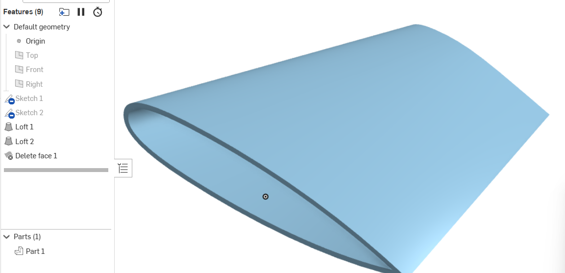

    I like to loft and upper and lower skin separately with over lapping trailing edge. Boolean together and trim trailing edge with delete face. This gets rid of the problem when lofting, thickening or shell that the curvature is too tight and trying to fold over its self in this case. One of the profile generators will allow separate curves.
    https://cad.onshape.com/documents/9a16e90e97ff0f49350854fe/w/8b1147e1bb96ce49e97d63d0/e/76e33ddfa2d5e580ac0eb4ba

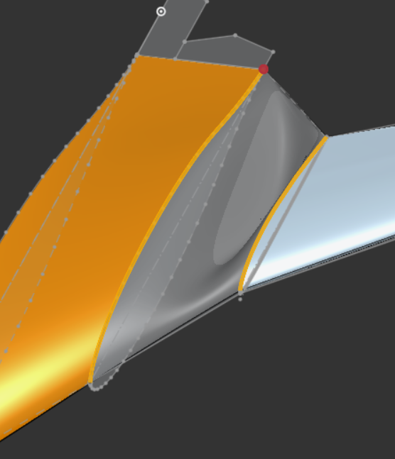

    Thanks, all. I'm going to go down the route of making it properly with surfaces. However, this geometry seems to be quite difficult to achieve:
    The 'match curvature' with the first surface conflicts with the guide on the back - the back has to have a sharp geometry, but also match the curve at the front.
  • SMURFCAD
    SMURFCAD Member Posts: 87 ✭✭
    @yanni_papadimitriou Looks like you are getting it figured out. Surfacing takes a completely different workflow that some struggle with, but you seems to have a handle on it.
