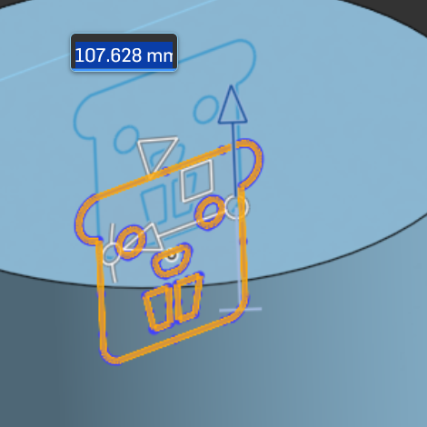

Hey! My goal is to put an image on a face and remove-extrude it. For this, I have an SVG file that I have converted into DXF. The problem happens after importing the DXF, when I try to center it on the face. Adding a dimension between any part of the image and a point on my object causes the lines of the image to break apart, completely destroying the image. I'm able to remove-extrude the image just fine, but I have no way of centering it. Any idea how I can fix this?

    So I'd have to select the hundreds of vertices in my DXF one by one and apply constraints to each of them?

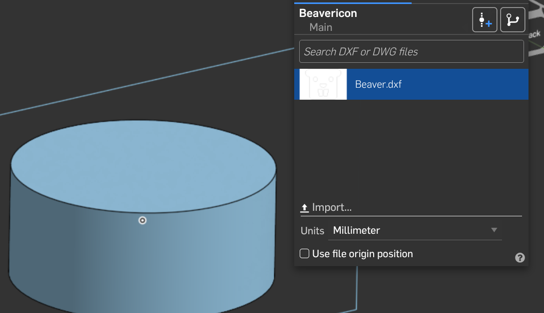

    Import the DXF. If you un-check "Use file origin position" , the center of the DXF will be put at the origin. If you check, the X-Y origin of the DXF will be placed at the origin.

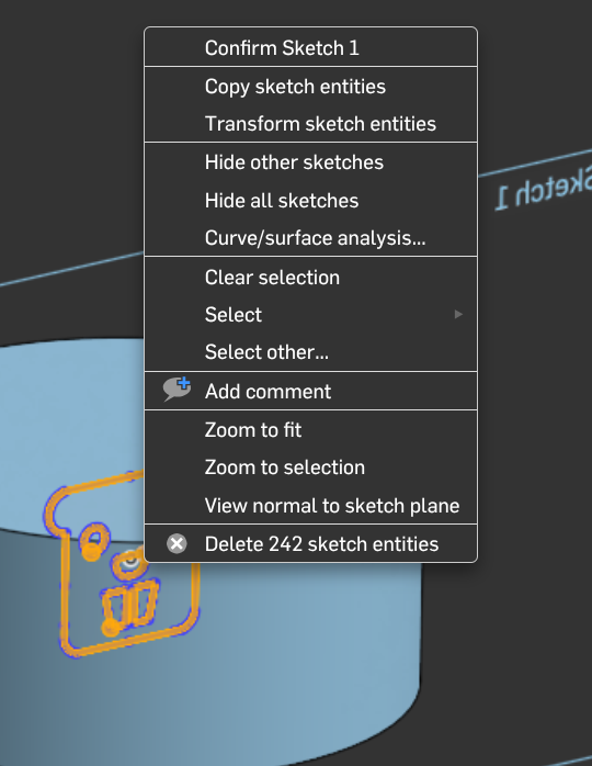

    Before leaving the sketch. Drag a box around the imported lines in the sketch.
    Then right click, and select Transform sketch entities.
    This will allow you to drag all the lines as one. You can scale here too.
    This will allow you to move the center set distances in X and Y.
