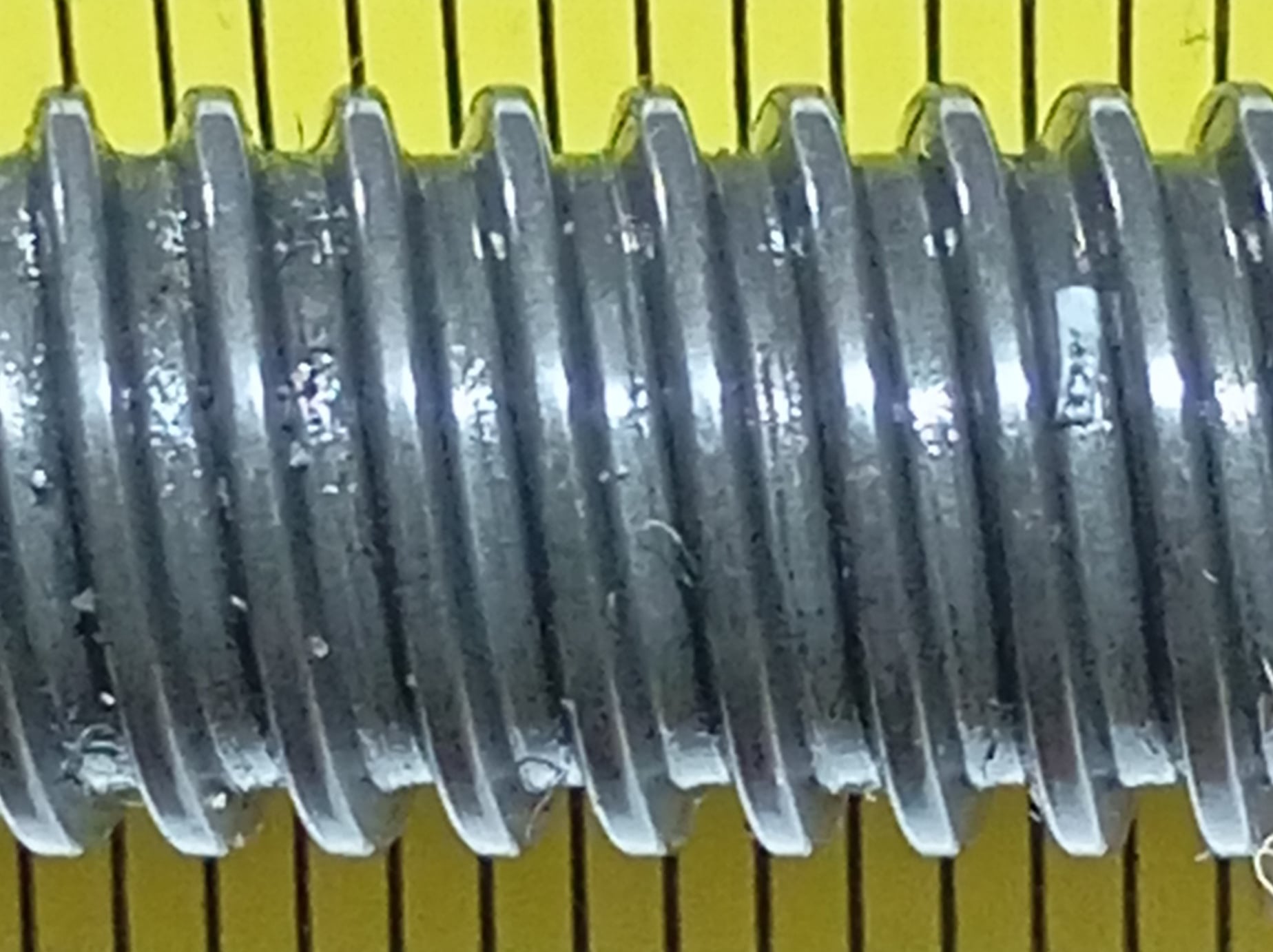

Hello everyone! Could you tell me how to make a nut for this trapezoidal thread?

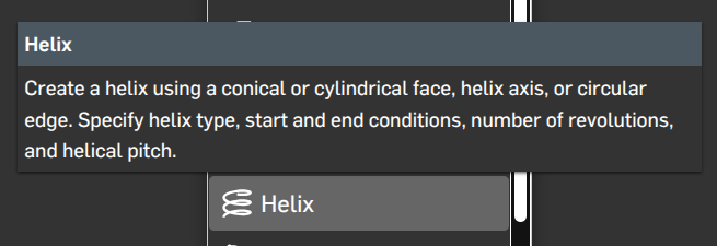

    if you have the thread on a bolt just make a nut around it and subtract the bolt from the nut.
  • SMURFCADSMURFCAD Member Posts: 59
    then Sweep.
