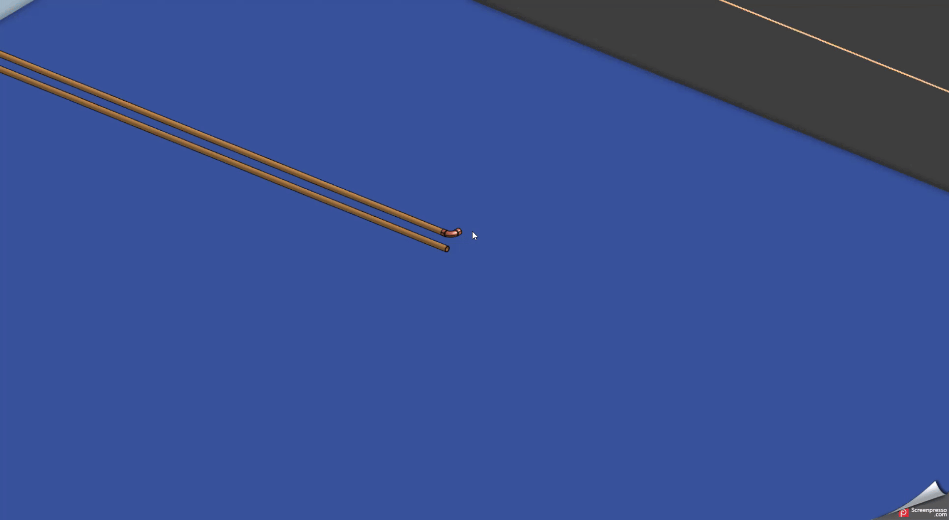

I am looking for a solution to paste-copied parts into the place in the same assembly, attached or mated to another point in the assembly.
The problem is that it is positioned visually to the near position but aligned with the plane parallel to the screen aligned to orign point
Look at the attached video to see what I mean.

    Hi, I have no problems with mates. I have a problem when I copy a part from an assembly and paste it into the same assembly. If the assembly is large in scale, and small parts are pasted into it, they can hide behind other parts (ctrl+c > ctrl+v). It would be very helpful if you could paste a small part near another part visible on the screen.
