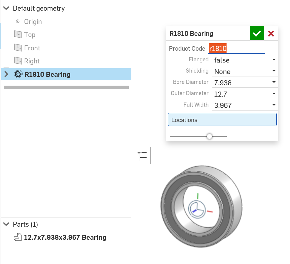

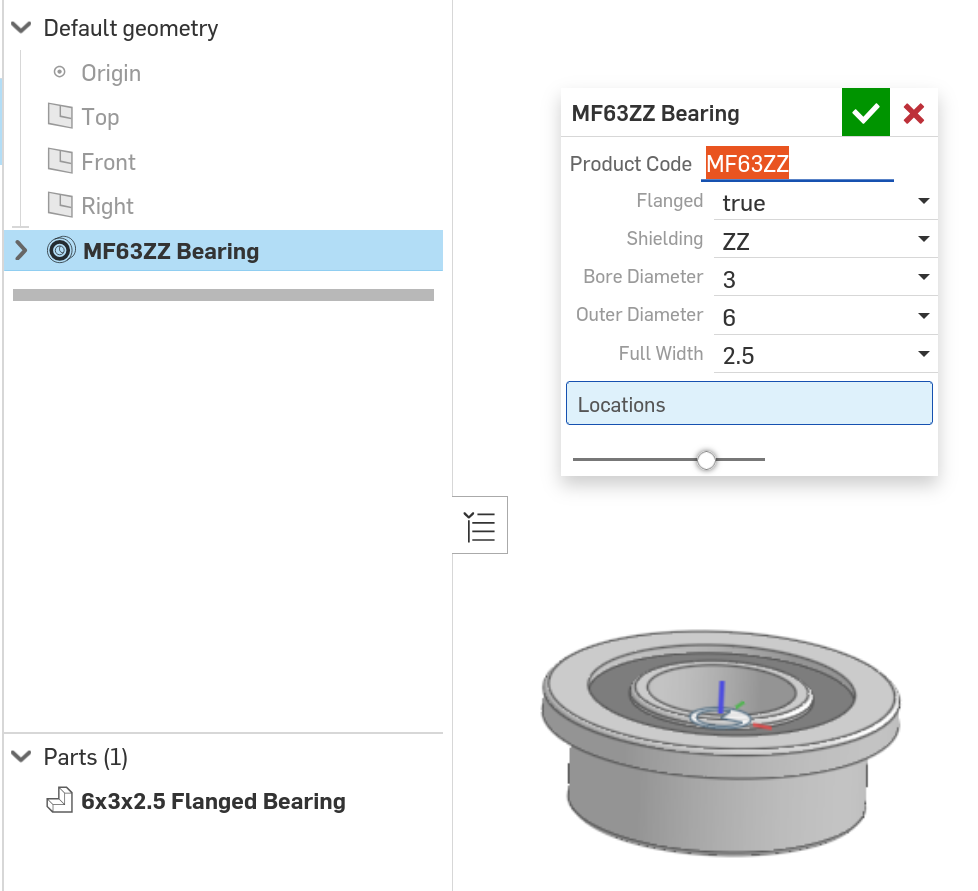

I needed to chuck an MR63 bearing into a project I was working on, and got a little sidetracked. Built a custom feature to generate deep groove bearings for basically all ISO standard sizes. Includes the following bearing families:
6000 series
160 series
MR series
MF series
600 series
F600 series
R series
FR series
in total, database includes 1,060 unique bearing profiles currently. Will likely expand in the future when I need a more obscure bearing in one of my projects
All dimensions should be accurate (including raceway/abutment geometry).
data based on
Product code and lookup table are bidirectional - specify one and the other gets filled automatically (so you can either paste in a product listing or look up the dimensions to get a product code)
Should help us engineers who struggle with the confusing name schemes for the billion different numbering patterns for different bearings lol
snag the custom feature here: https://cad.onshape.com/documents/e4a030aab7d1433266c719eb/w/0435c62a020b7f27bb7dccd8/e/65d7056e9475e89c660260c4
