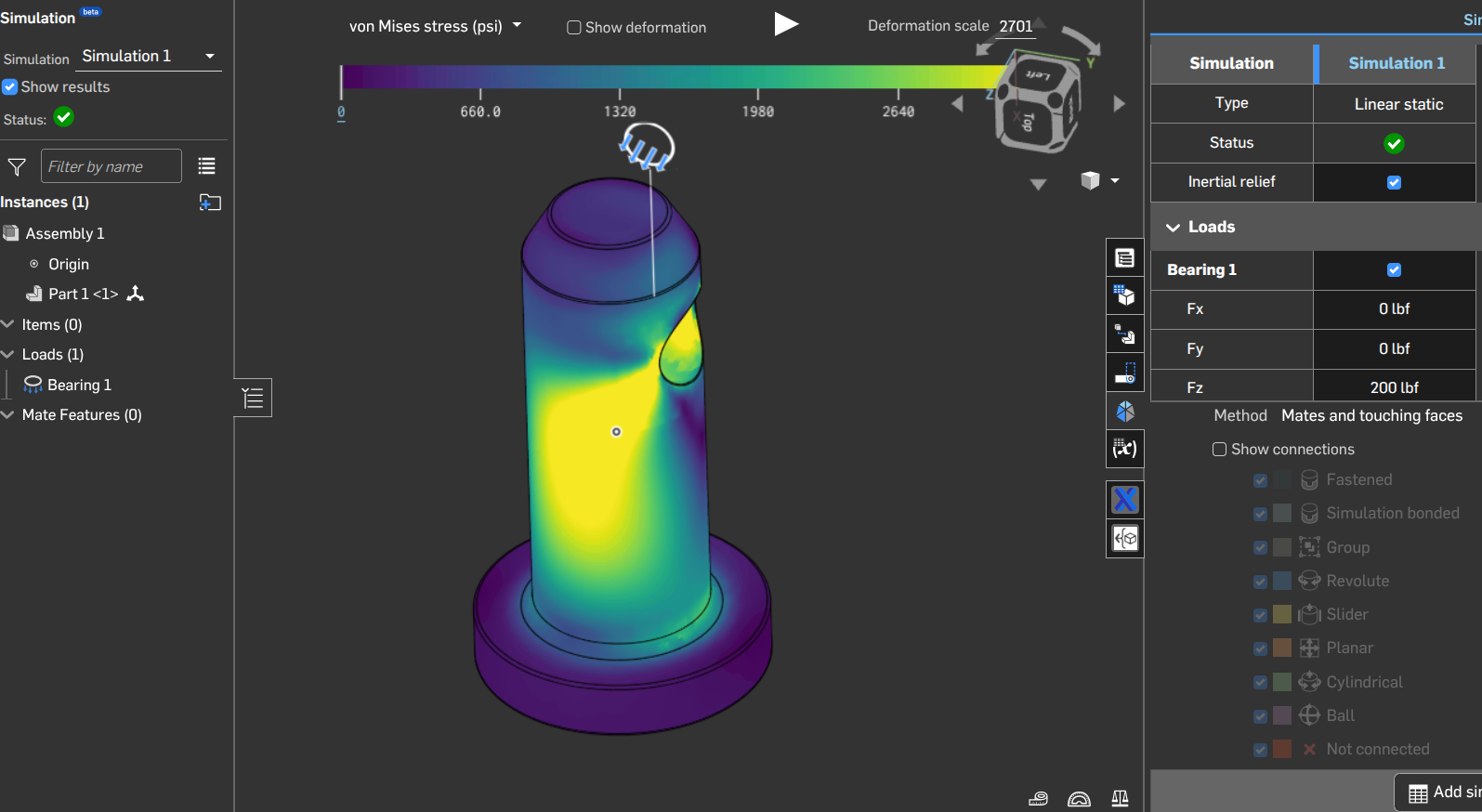

I imported https://www.mcmaster.com/90156A609/ into my design. I am trying to run a simulation to see how the hardware reacts under load. I assigned materials to the imported parts, but Onshape serves a
"no material applied" error.

    Screenshot or Link? There's a chance you applied a material that doesn't have the requisite material properties?

    Nothing special about the mcmaster part. Imported fine. I did delete the ball before simulating.
