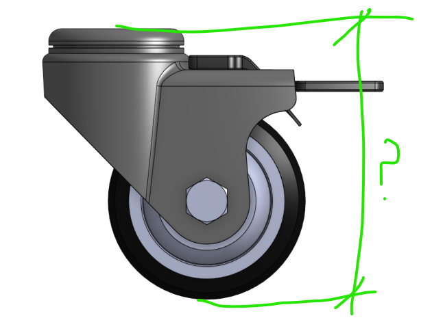

    but the existing part's dimension is unknown so the value for the formula of "measured dimension" is unknown, i tried to measure a caster wheel from bottom of the wheel to the top most part of the mounting plate but cant find a way to do this. i have made a framing and use a public model of caster wheel, but i need to scale it to a desired height proportionally.

    wille_j Member Posts: 155 ✭✭✭
    If you can share the model it's much easier to help.
    Generally, if the model has irregular shapes the measure tool can't reference, best route is to make intermediary sketches off the geometry to get stable sketch references to measure from instead. And then use the scaling factor calculation Eric recommended.

    im trying to find a tool to measure this overall height but i cant. this a derived public model that i want to scale to a specific dimension

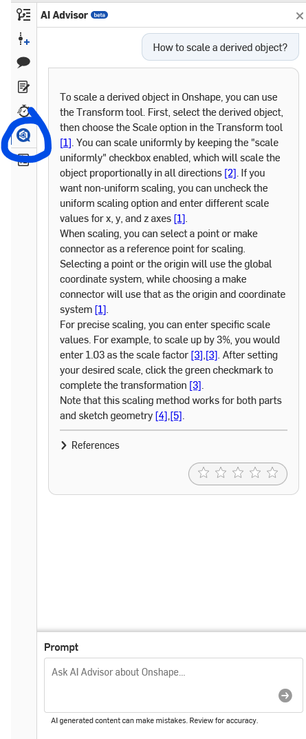

  • MDesign
    Give the help file a try. or the AI advisor. You can't scale to a dimension unfortunately. You can scale to a factor to get to that dimension. You don't have to do the math. just have the existing measurment and enter a formula in the scale prompt… like "newdim/olddim"
