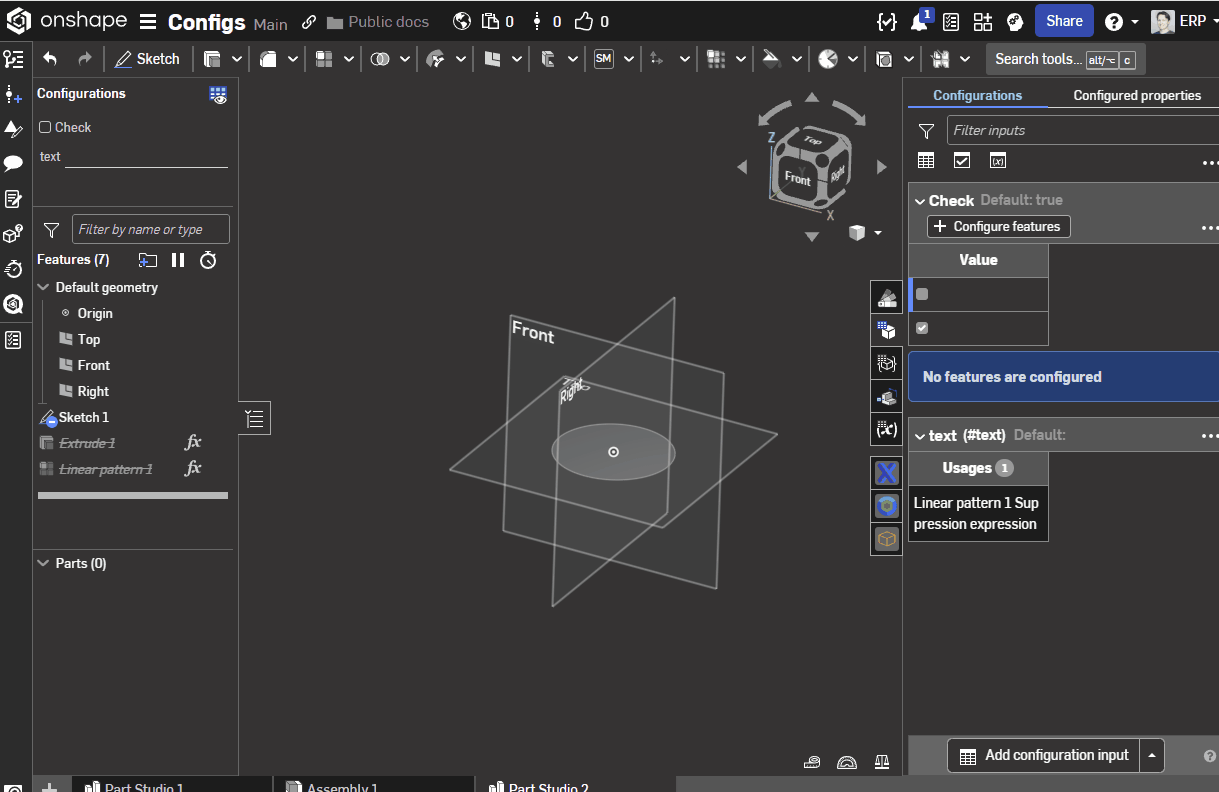

    I'm not sure I understand exactly what you mean by:
     However, it appears that the configuration variable doesn't automatically update when I switch configurations.
    A configuration variable will be set to whatever you set it to… Can you share your document or at least some screenshots of what you did?

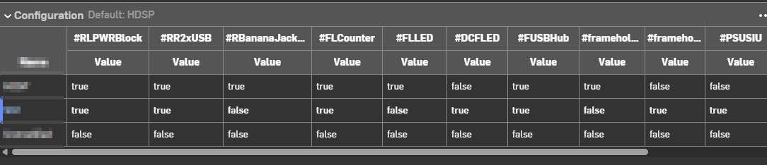

    I am able to use dynamic suppression with either a configuration checkbox or using a text variable:
    Also your approach of using a variable feature and configuring its value is valid, I have used it to provide a granular control of sets of features in a config table. Kind of similar to what you are doing actually as it's an enclosure with different "sets" of cutouts (proprietary so can't share)!
