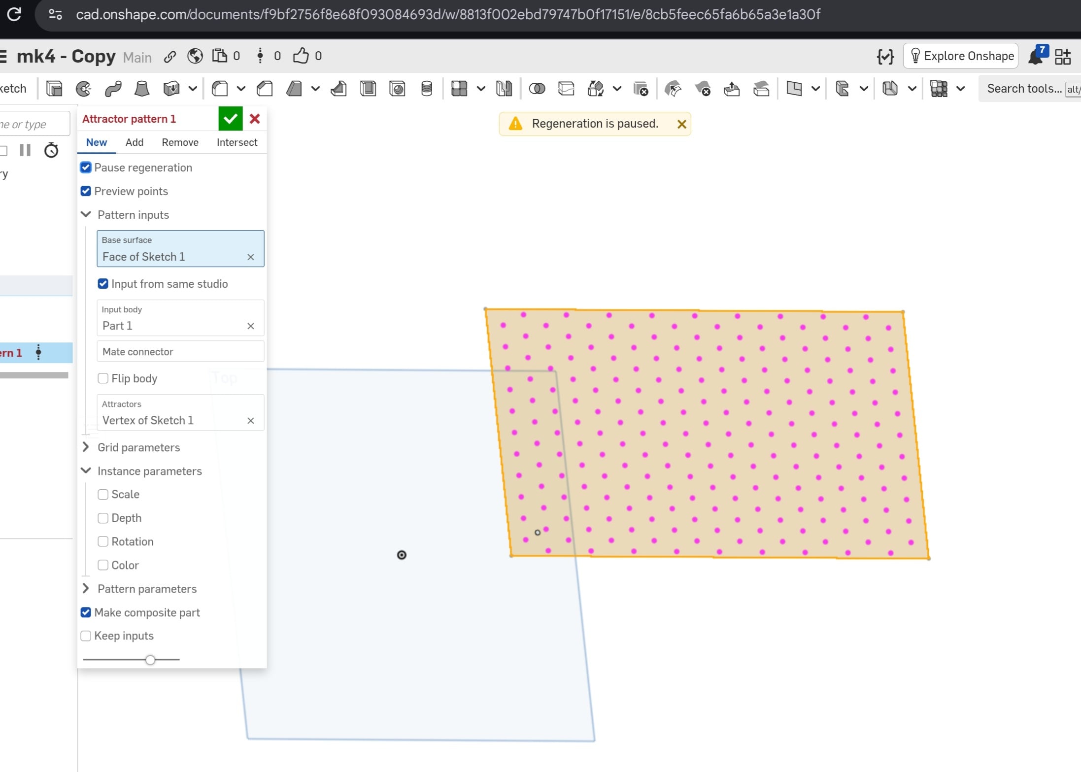

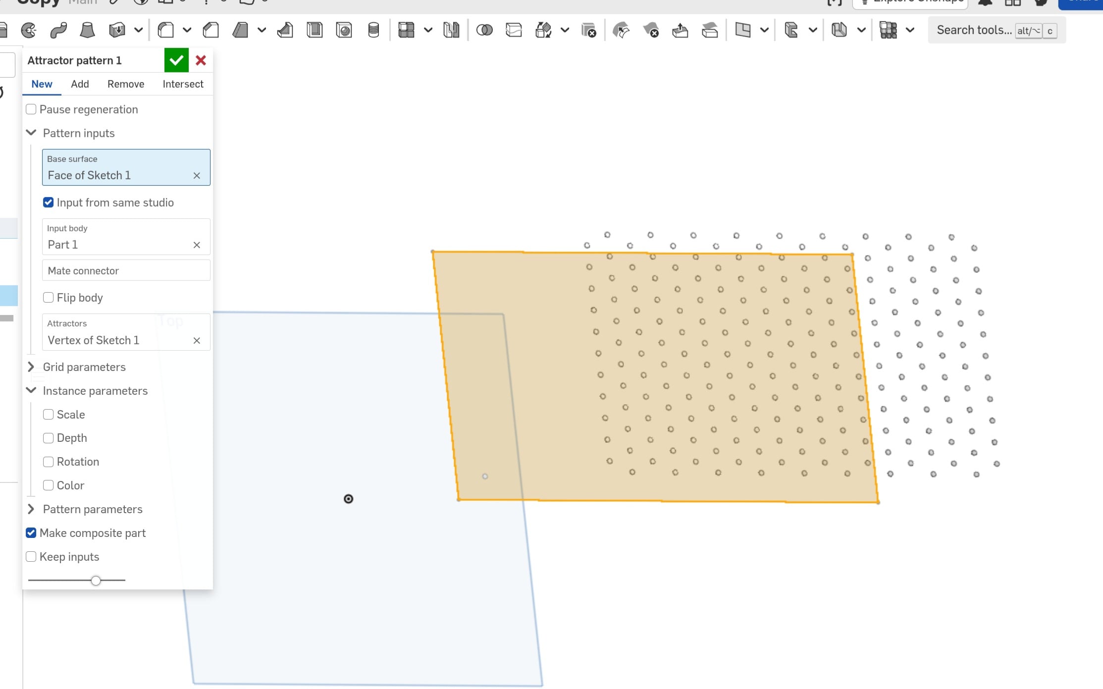

trying to make a golfball like pattern to a handle, but i cant get the halhalf sphere to stay inside the sketch. only when i press ''pause regeneration'' it will snap in to place. please help!

    Hard to tell without seeing your document, but I'm guessing Part 1 isn't modeled on the origin? The pattern places the part on the magenta points you see relative to the world coordinate system.
