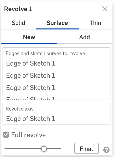

I made this pin and want to cut a section out to make it 'pinchable'
But I cant cut it out as it throws me the error "No merge scope"
Which is as I asume from the fact that onshape doesn't consider any parts are in the project yet, it only lists one surface.
To me the part is fully closed off.
I used the revolve function and even went back in the drawing to make the end and finish point vertical
I had other timed today where onshape just woundt work with me at some times, and I'm slowly going mad now

    Your revolve is set to surface not solid.
  • Matt_Shields
    You used Surface instead of Solid for your revolve. Yes, the surface fully encloses a region, but you explicitly selected Surface so Onshape gave you a surface. Use Enclose to turn the surface into a part or use Solid instead of Surface.
