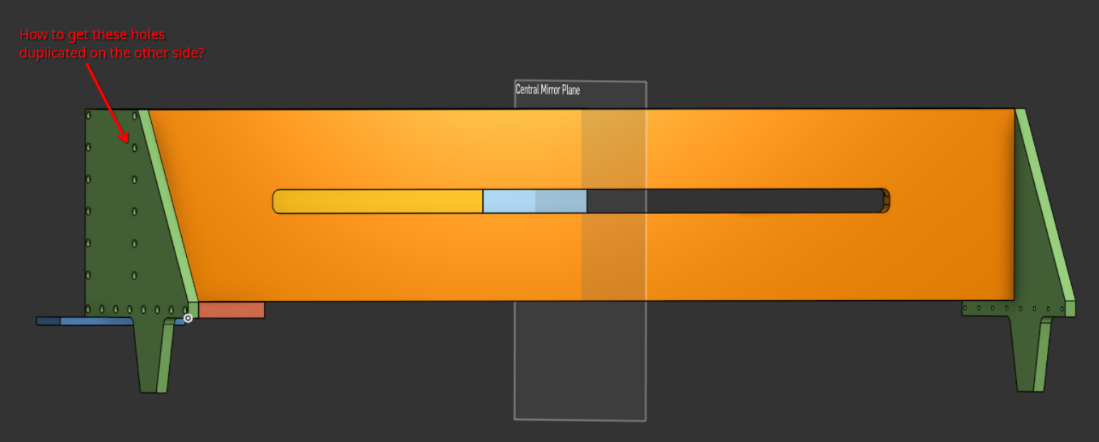

I'm fairly new to OnShape and CAD in general so please excuse me if I use the wrong terms.
I'm building a CNC machine, the image below shows the gantry. I've mirrored the left side plate over the to the right.
On the left side plate I've added a number of counterbore holes. The threads are in the edge of the orange front plate. When I mirror the left side plate the holes in the side plate mirror but no holes appear on the right hand side of the orange front plate.
I think I understand why, the mirror is mirroring the entity not all the operations so it couldn't possibly know it needs to drill holes on the right hand side of the front plate.
I can draw points for all the holes I need on the right hand side but that doesn't feel like a good solution (it fails the don't repeat yourself test).
Thanks for any help.
  • Matt_Shields
    Assuming you are in a Part Studio, in Onshape, you can mirror Parts, Features, and Faces. In this case, a part mirror will do exactly that: bring the green part over to the other side. It won't mirror the hole feature that created the holes in the green and orange parts. If you mirror the feature, what will do it.

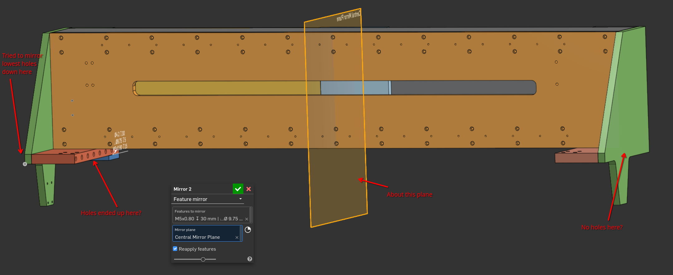

    However, I've hit a second problem. When I mirror about the central plane I have drawn the holes appear in the wrong place. They appear in the red part on the left hand side rather than the right hand green part. I've tried selecting a number of different planes as the mirror plane and the holes always appear there.
  • Matt_Shields
    Try going into the hole feature and make sure that both green parts are included in the Merge scope.
