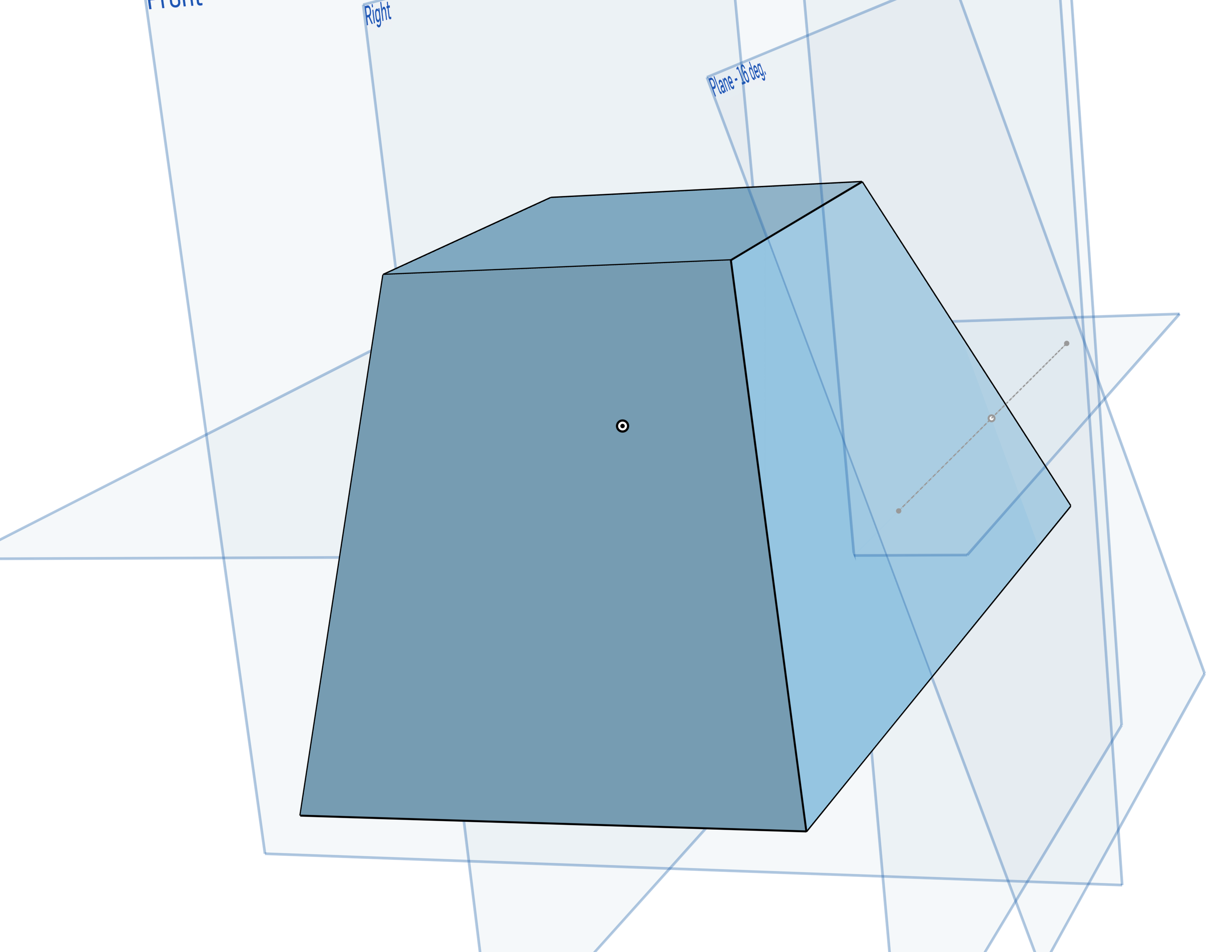

Preciso desenhar um cubo, uma das faces terá um ângulo de 16º onde faço no esboço e já faço a extrusão. O problema vem agora, as duas faces laterais tem simetricamente um ângulo 55º. Parece fácil mas não estou conseguindo, aguém me ajuda?

    Use the Draft command.

    "I need to draw a cube. One of the faces will have a 16º angle, which I'll sketch and then extrude. The problem is that the two lateral faces symmetrically have a 55º angle. It seems easy, but I'm having trouble. Can someone help me?"
    I'm not exactly sure this is the shape you were looking for, but here's one way to do it:
    I created a plane 16 degrees to the right plane. Then sketched a trapezoid with 55 degree opposite sides, and extruded that "up to face" using the 16 degree plane as the face.
    Nick mentioned using Draft, and I was thinking "but that will affect all 4 sides". I had no idea there was a draft function separate from the one inside the extrude function. That will be useful….thanks Nick! And would have been quicker in this case.
