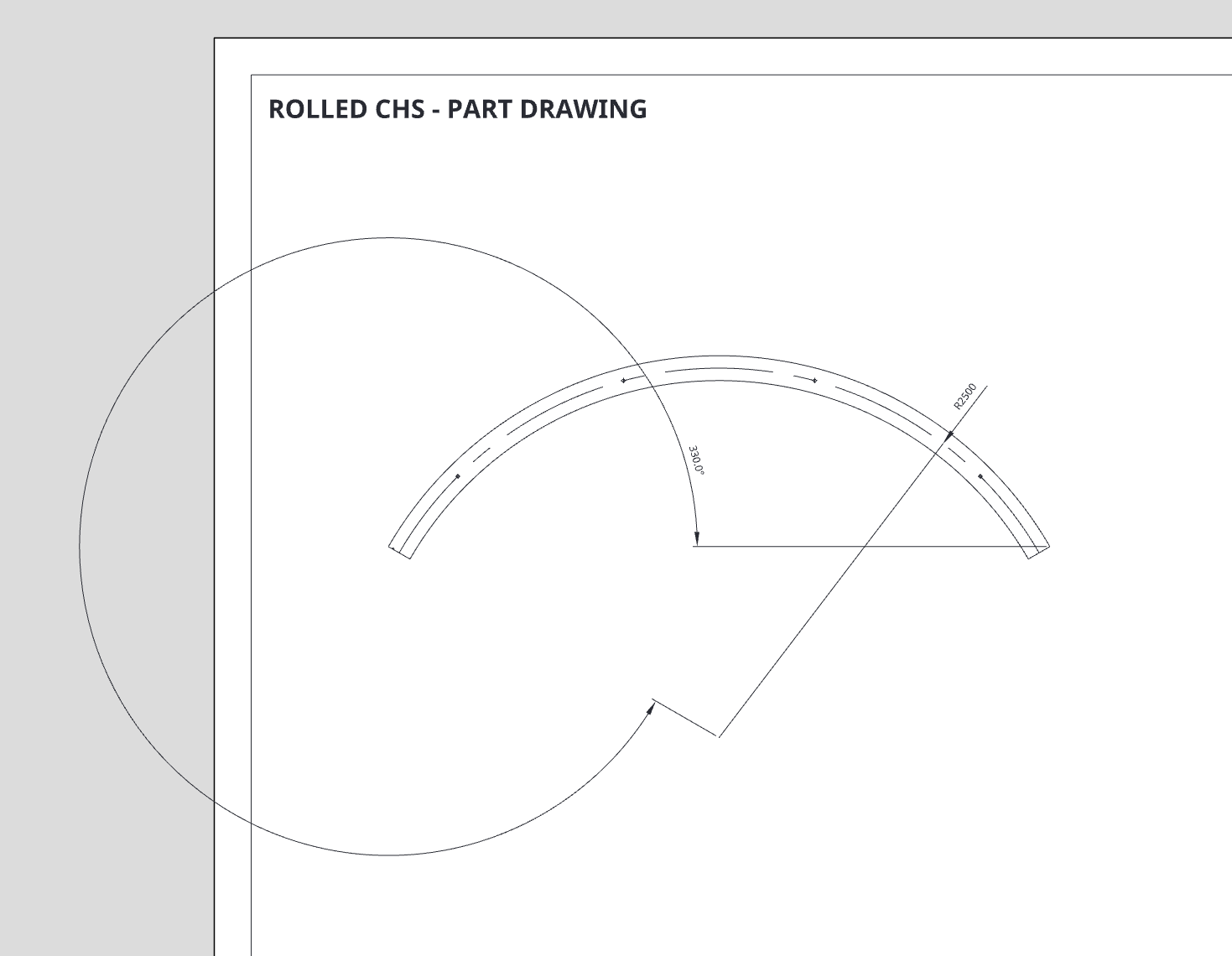

I'm trying to dimension a curved pipe's arc length in a drawing. I used the dimension tool, clicked start, end, and the arc itself, but this doesn't work. Instead it gives some sort of angle dimension instead.

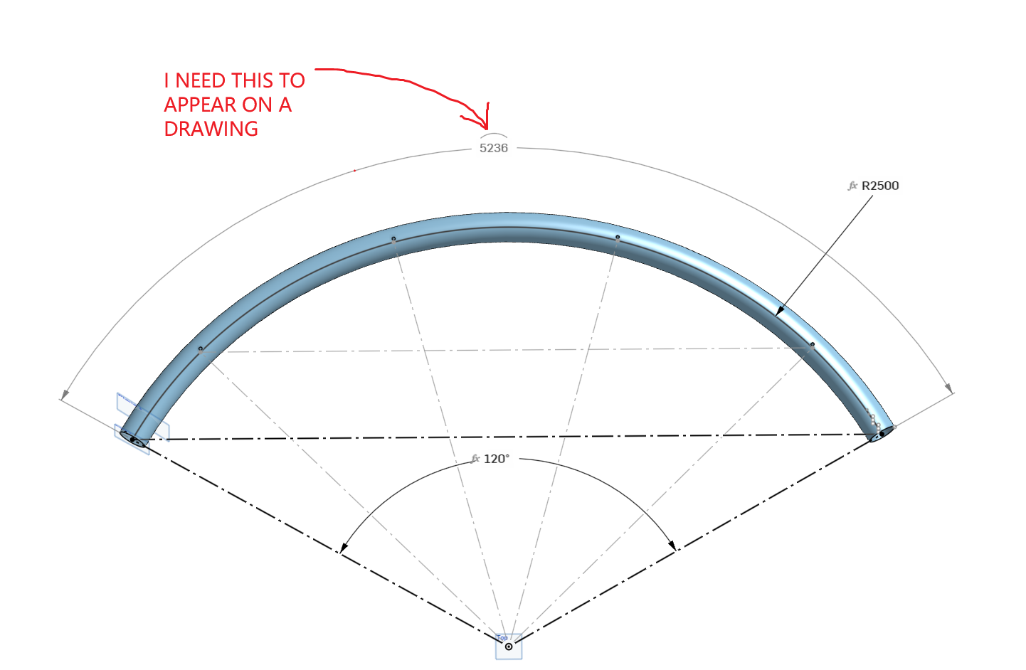

The pipe is created from an arc in the part studio, and I can dimension the arc length without problem in the part studio sketch, but now I need that dimension on a drawing.
@Yuxiao_Wang We are in development with this at the moment. I created a support ticket for you as well.
1 -
@PeteYodis dang I lost a bet with someone about this capability today because it's available in the sketch environment. Guess I should interact with drawings tabs a little more often.
I have same problem….hope it gets fixed ….guess I might use print screen to have the dimension.
