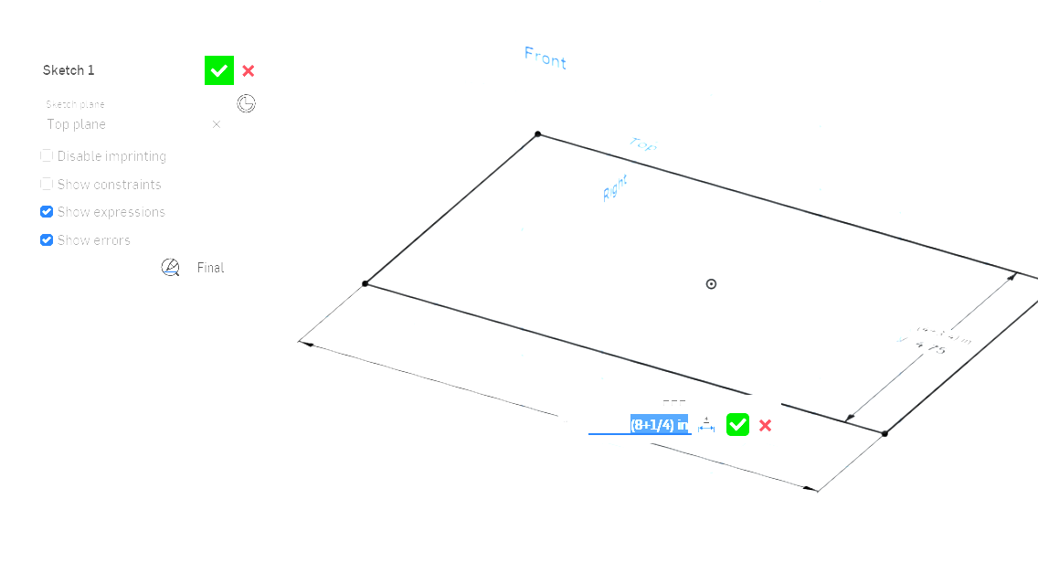

I cannot hand my manufacturing team a sheet with a length of 23.482 and expect them to do the conversion. Is there a way to create a cut list rounded to the nearest 1/16" or show it in a fraction?
Not with the standard tools. May be someone has done this in a feature script?
If you draw in fractions and set drawing property to fractions at least the layout will be fractions. But not the cut list.
This looks like a subject for an IR if you are going to want a lot. Both work space units and cut list would need updating.
I'd vote for it.
I went ahead and made one for my needs but there are others
