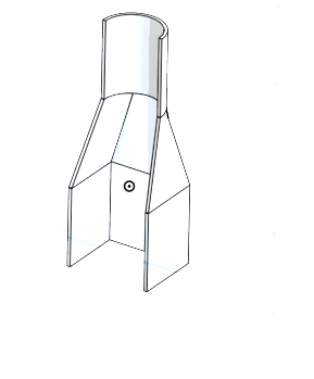

I have been trying to loft a half circle with a square with the top missing (Three sided.)
I then tried to divide the half circle into three parts so they would be equal parts to the 3 sided square.
I have done this before but now unable to. If you can get to my onshape it is you will see it.
https://cad.onshape.com/documents/962b143c3b6cc49a2b66f9ce/w/43d21699ec027d4be1980a91/e/a8ab766731b3b40fcc675133?renderMode=0&uiState=6a320ec7301da3e6c7045813
Try this with extrude surface for the ends and a lofted surface between. Then thicken to suit. The radius sketch for the top is 3 arcs which makes the loft work work easier.
