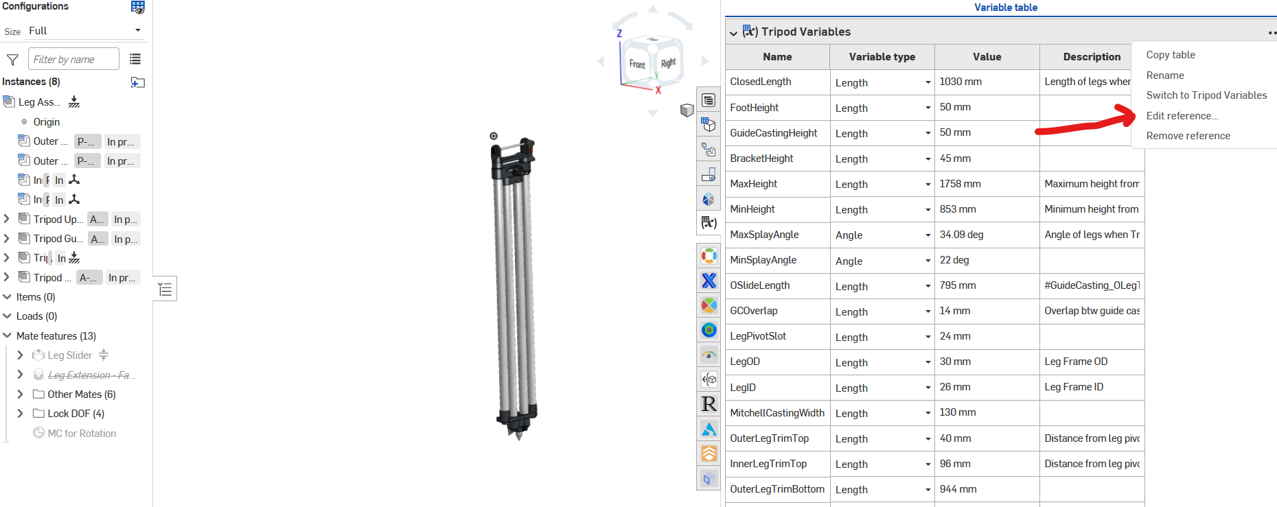

You can reference a Variable Studio in an assembly, but you can't configure that value just for the assembly (like you would for a local Part Studio variable)

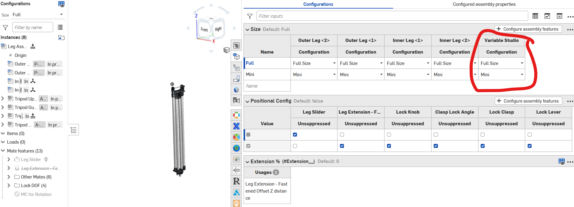

The best approach it to create a configured variable studio, that has your "High" values and your "Low" values. Then in the assembly, you reference those variables in your Assembly Pattern (or whatever you need the Var for), and you "Configure" the Variable Studio insertion for that assembly.
