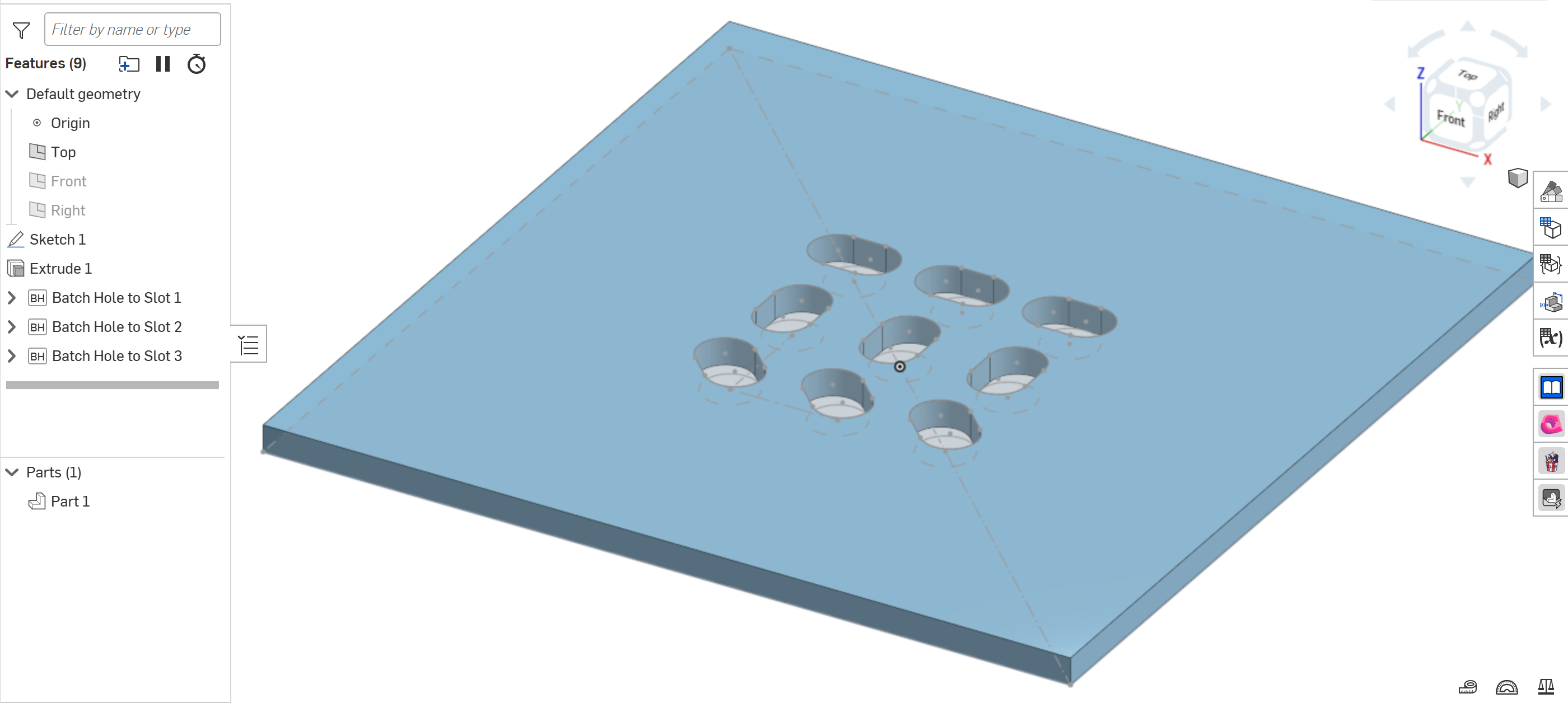

I made a FeatureScript custom feature for converting selected circular holes into slotted holes without editing the original sketches.

How to use?
- Select one or more circular hole faces or circular hole edges
- Select a slot direction reference.
- Choose Extra travel or Total slot length.
- Choose Symmetric, One-sided positive, or One-sided negative.
- Optionally override slot width.
- Run the feature.
Supported
- Multiple holes in one feature
- Different hole diameters
- Extra travel mode
- Total slot length mode
- Through-all cuts
- Direction projection perpendicular to hole axis
Current Limitations
- Normal solid parts only
- No sheet metal-specific support yet
- Through-all only for now
- One shared direction reference for all selected holes
