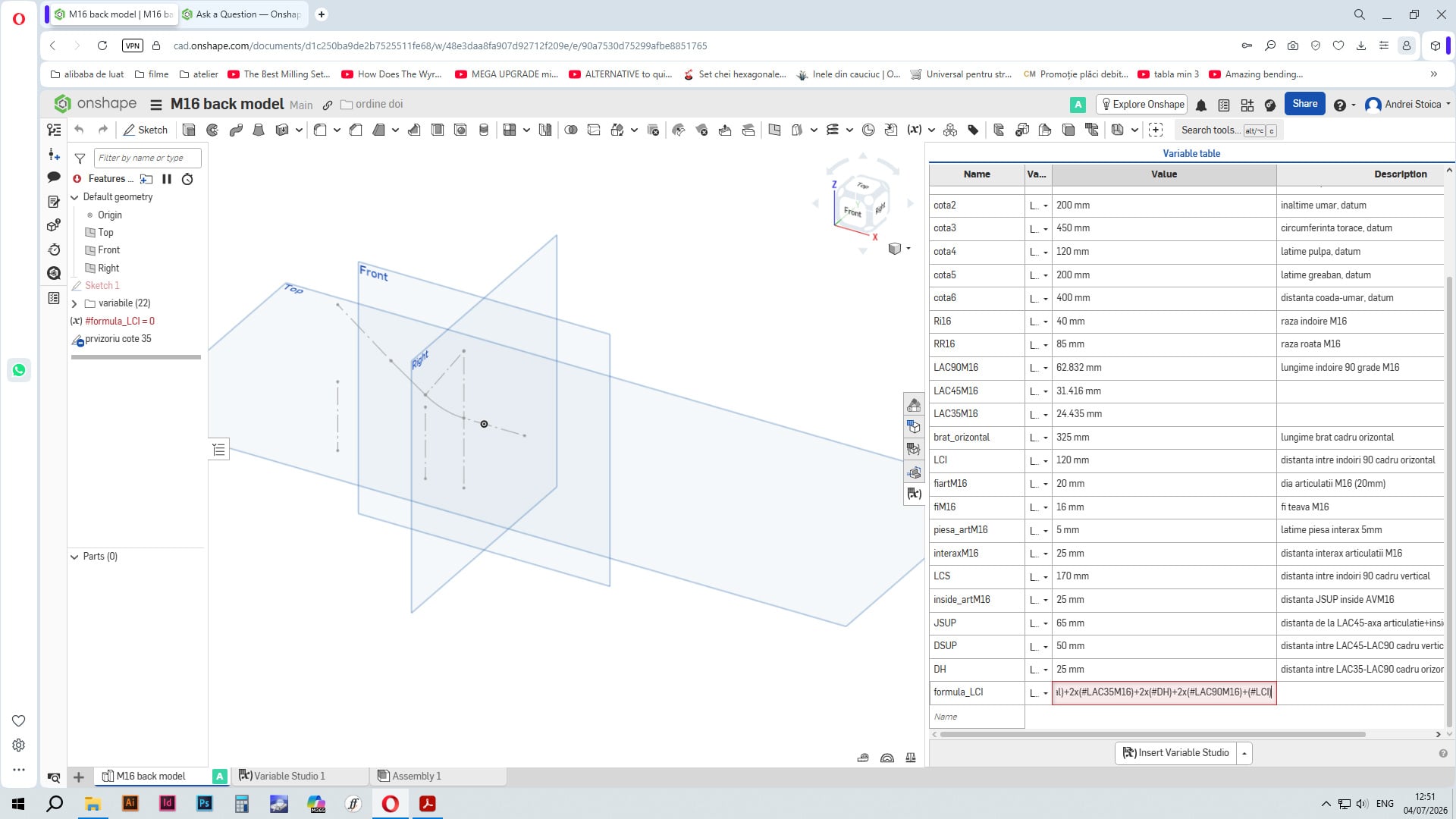

hi! I need to calculate a length of pipe with various bends, I have created a variables table, but I run into a problem:
neither of these syntaxes works:
2x(#brat_orizontal)+2x(#LAC35M16)+2x(#DH)+2x(#LAC90M16)+(#LCI)
(2x(#brat_orizontal))+(2x(#LAC35M16))+(2x(#DH))+(2x(#LAC90M16))+(#LCI)
[2x(#brat_orizontal)]+[2x(#LAC35M16)]+[2x(#DH)]+[2x(#LAC90M16)]+(#LCI)
can someone help me with this? thank you, in advance

    use * not x for multiplication. Post back if that doesn't fix it.

    thank you! it will surely work - at the moment it seems I have some problems using OnShape, seems like connectivity issues (and I am on 1GB fibre optic) - basically nothing works, maybe in the next few days it will resume working
