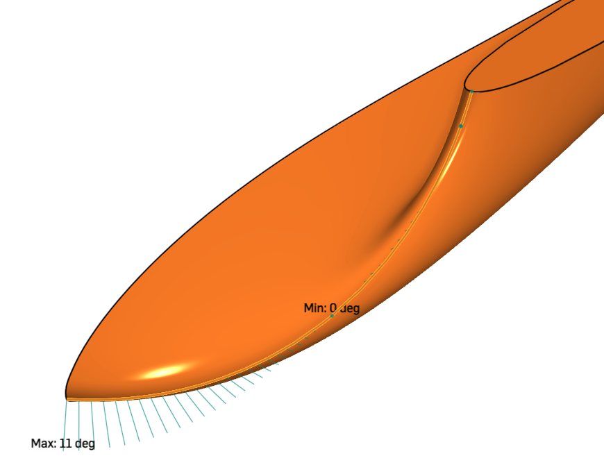

I had already often problems with lofts, but the actual loft gets me crazy.
The Feature "Winglet Übergangsbogen" doesn't work.
https://cad.onshape.com/documents/a138fe94d7d1cc480c782009/w/549f911486f55a507d4050ca/e/2f3fd09df23d66ba4577e91c?renderMode=0&tangentEdgeStyle=2&uiState=6a4f6b48244defd18d26d0db No matter what I try, I cannot loft between the two profiles with the guidance of trailing edge and nose edge. Trailing edge guide alone does work, but the nose edge always crashes… I really hope you can help me. Thanks a lot!

There are a number of issues that you might want to look into:
- theWing Aussen airfoilsketch is made of piecewise line/arc segments and has a number of jumps in curvature
- there is a large (11 degree) intersection angle between segments at the leading edge of the same sketch - this will cause all sorts of issues when you try to useConnections
- the break in tangency (mentioned previously) is in a different location than the end of theCurve 3which you want to use for the Guide, again this will make the Connections very complicated
I messed around in a new public link copy here and tried a couple of things:
- I made a couple of approximated Composite curves instead of theWing Aussen airfoilsketch (basically it approximated the piecewise segments into a continuous spline)
- I made a new guide curve for the leading edge, and I started it from the more obvious location. If you compareCurve 7(my new one) and the oldCurve 3you'll see they are very close, but the strat point is shifted.
With the new profile curves and the new guide curve, the loft completes without issue. Except for the fact that there is a dihedral of 11 degrees as previously mentioned. I think you should focus on fixing theWing Aussen airfoilsketch some more and then things should fall into place.0
