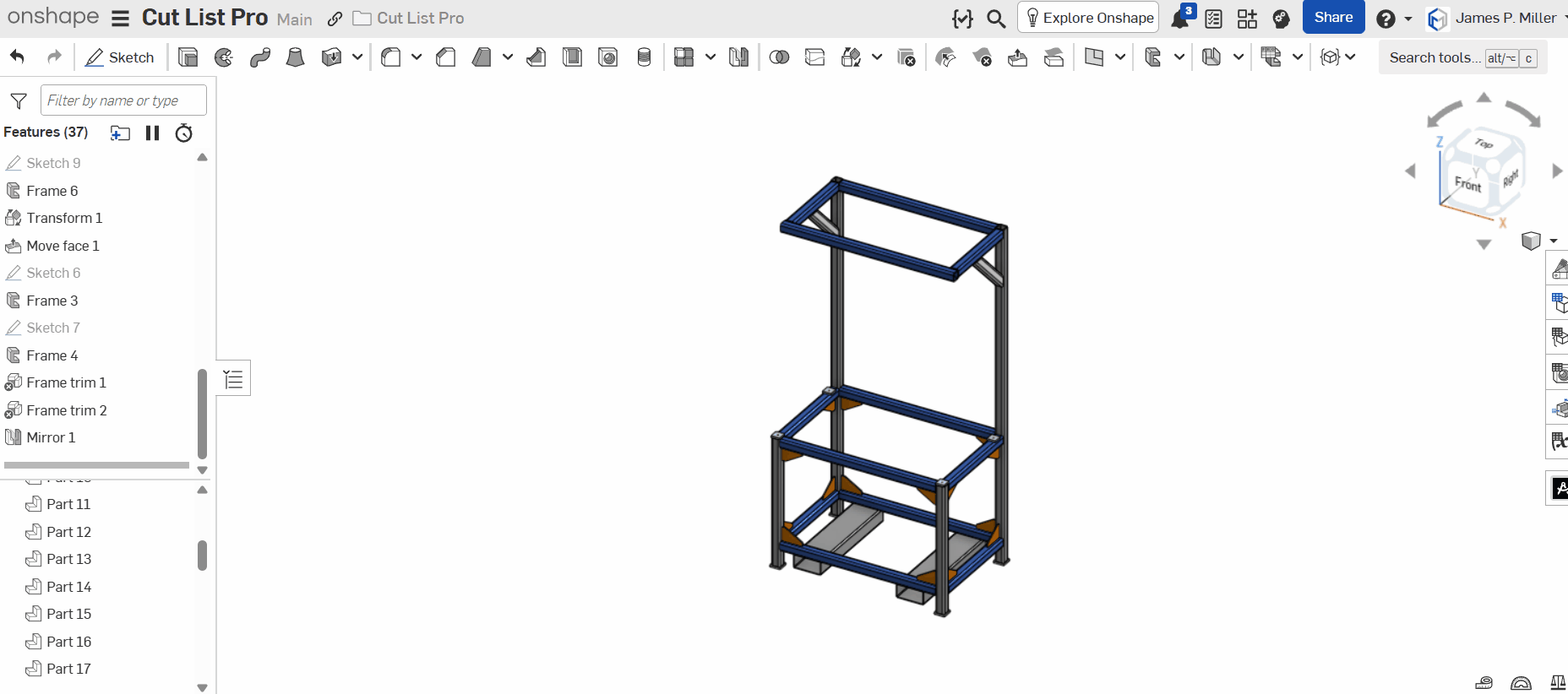

I've always wanted a simple to use tool for generating cut lists for weldments and decided to have a go at creating one. I came up with what I call Cut List Pro.
Cut List Pro eliminates the repetitive task of manually sorting structural members, producing cut lists in seconds. Sorts by member type, then size, then length. I've included several override functions and a manual drag to reorder, if needed. Adding additional items later are automatically sorted into position as well.
It's almost finished and I was wondering if anyone would be interested in a temporary trial to provide me with feedback? Here's a video showing some of it's abilities.

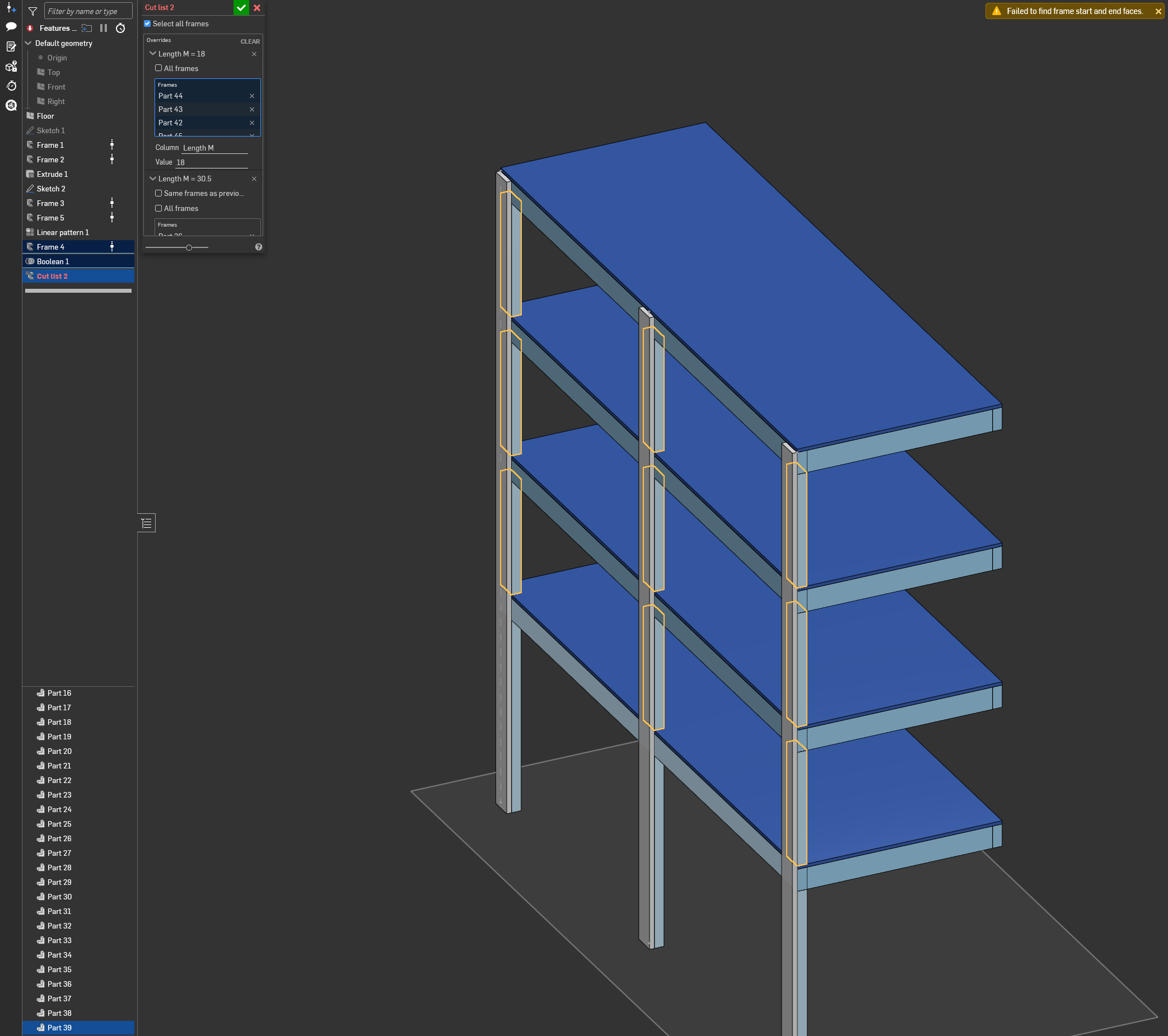

    Does it work even if frames are cut using a Boolean ?
    The classical Cut List fails to generate when frames have both ends being edited or cut off.
    Like here.
    I'm open to test, I also understand that you would like to be paid for your work.
    I just wish you would release a community version with super basic features but that support frames being cut before the cut list. That would be awesome.
    I can see how professional use would need the other features you implemented anyway and would be willing to pay anyway.
  • James_P_Miller
    James_P_Miller Member, csevp Posts: 38 PRO
    edited August 11
    @Patrix87 I tested it and it was able handle parts that are boolean cut. I'd be happy to give you a one week trial if you'd like to test and give me some feedback. You can sign up at www.millerdesignservices.net/feature-scripts
