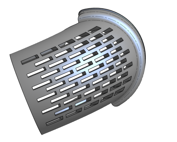

I'm trying to make a cover clip for a Cpap vent filter and although I could do it manually using planes and just extruding out each vent hole, I'm trying to learn how to kind of wrap a crurved surface with a pattern and then extrude that pattern out?
I've come across this a few times and being of the older generation and not totally up to snuff with all this stuff, I can't for the life of me work it out.
I;ve made plenty of repeat paterns before but I'm trying to place that pattern on a curved surface and extrude it does't seem to work for me anyway I try.

    Hey Damo, this is possible but there are a few different ways to do it. We will need a link to your document so that we can see the shape of the part and where your trying to apply the vent holes.
    If the model is only bending along 1 axis and the part isn't too curved along other axis, then you can pattern the extrude along a curve. If its more complex, then it might require more advanced pattern techniques which we can show you.

    Im wanting to do oval shaped holes in this clip cover in a grid pattern not just lines as with the lines like this it's taken a chunk of strength out of it when 3d printed and it's a part that clips over another so I'm thinking smaller ovals that are staggered would add a little strength back into it.
    I've also had this issue trying to model up a gold trommel which the simple way you suggested would work well there, the clip is on 2 different planes but could probably be extruded as I've done with the long straight ones.
    Have a look if you want, it's a bit of a mess as I'm litteraly just a hack at this and really need to learn how to do correct workflow hahaha.

    I think I follow what your trying to do. There may be a featurescript out there that might help but I can't think of any. I think you will need a pair of revolves and circular patters.

    mate thats pretty much exactly what I was wanting cheers.
