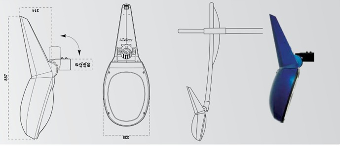

Hi Guys!
Can you help me how to create a model of this item by using this drawings?

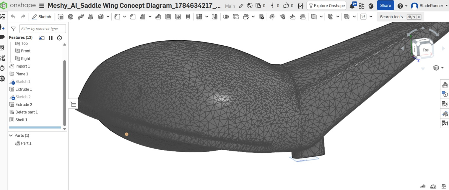

I generated it with AI it is good, but there are a millions of polygons, and the whole surface is only one surface.
Thank you!

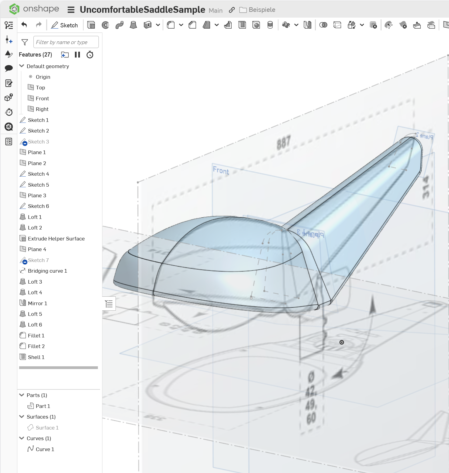

This has me scratching my head quite some, because if it was made by AI, why not have a real good talking to with said AI and prohibit it using meshes in the future? Make it use vector surfaces right away. That shape is not actually that complex, so your average AI should be able to handle it.
Also, the AI has cheated on you in some places in the 3-view drawing.
Anyway, you could approach the thing by placing the drawings on planes and model over them. Below is a quick and dirty demo just to show the idea and make clear it is well within feasibility:
Michael Pascoe is right, though: Follow the learning pathways he linked. There is no such thing as free lunch. ;0)
