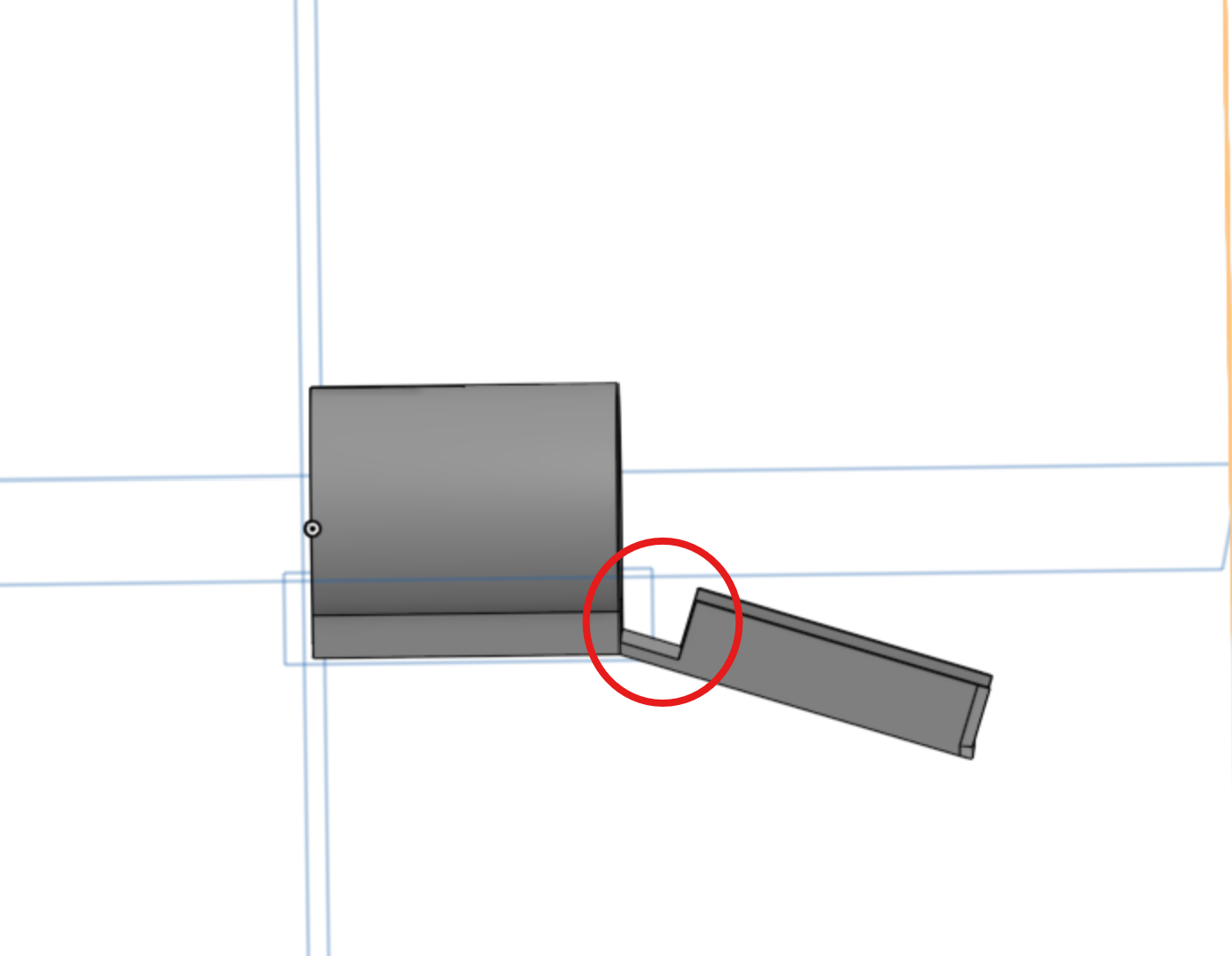

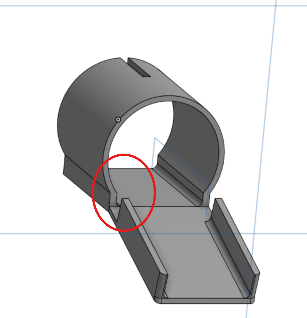

Looking for assistance completing this model. I'm having an issue figuring out how to join the angled walls of the drain ramp to the main circular body. Ideally the walls would follow the circular shape where it joins.

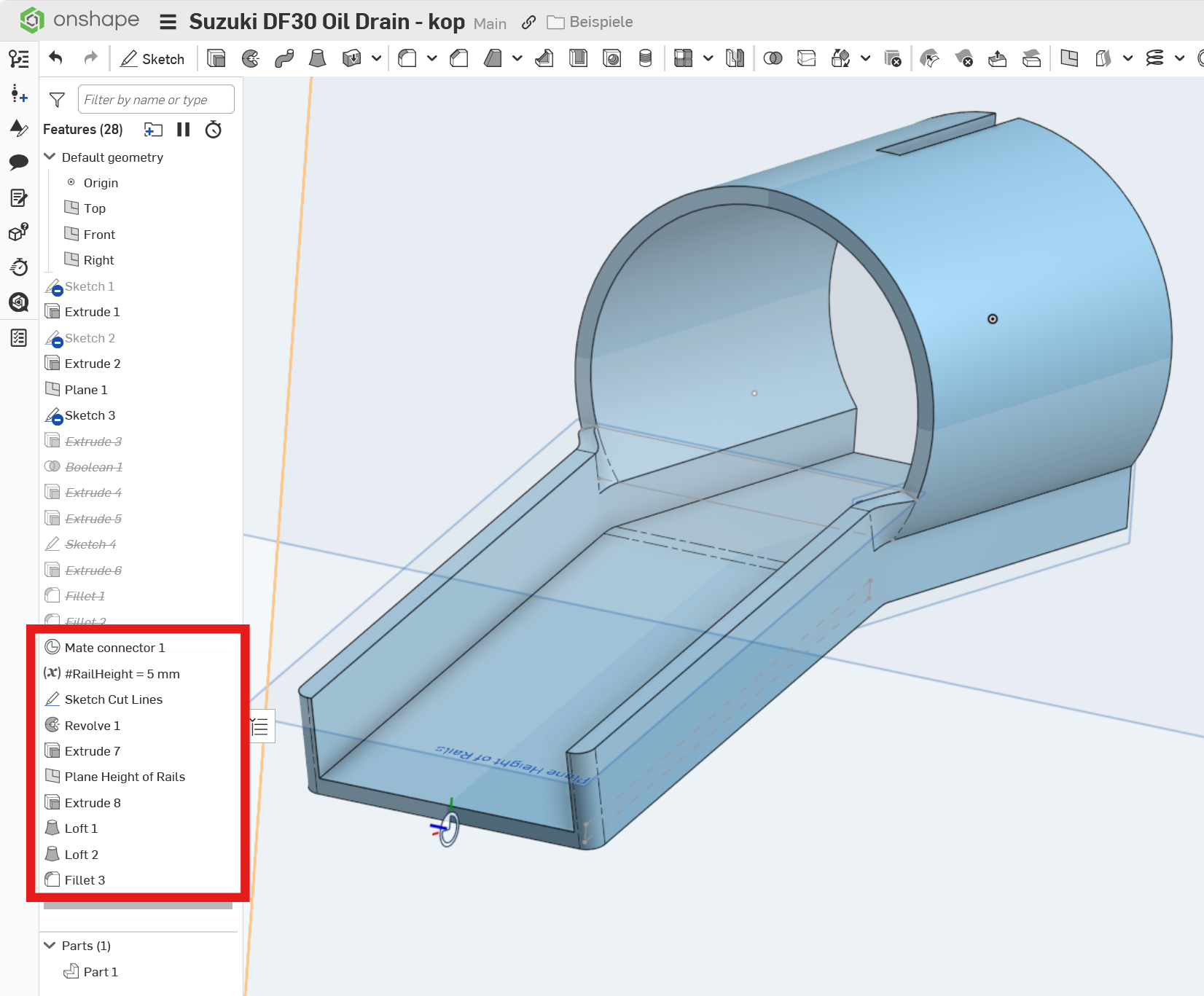

One important bit of information in such cases is usually: "How is it going to be manufactured?"
We could make a nice blended transition, but depending on whether you want it to be a protruded cross section with a cutaway and some post-forming process or a molded thing, printed, it depends …
Proposal:
Proposal:
(Deleted)
Martin. I can't thank you enough. This was definitely solved with features I'm not familiar with and need to learn. Thank you again.
