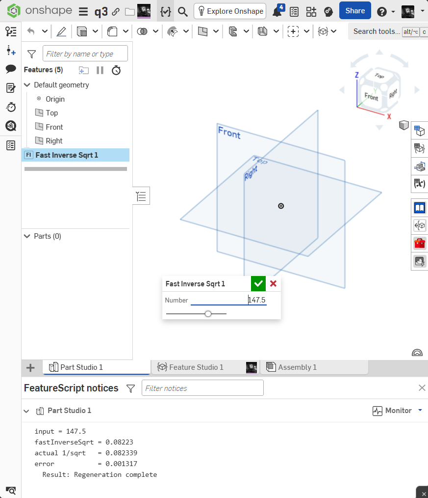

QuakeIIIArena bit-hack code written in featurescript
joshtargo
Member Posts: 695 EDU
FeatureScript 3029;
import(path : "onshape/std/common.fs", version : "3029.0");
const TWO_23 = 8388608; // 2^23
const TWO_31 = 2147483648; // 2^31
const BIAS = 127;
const MAGIC = 1597463007; // 0x5f3759df
annotation { "Feature Type Name" : "Fast Inverse Sqrt", "Feature Type Description" : "" }
export const testFastInverseSqrt = defineFeature(function(context is Context, id is Id, definition is map)
precondition
annotation { "Name" : "Number" }
isReal(definition.inputValue, POSITIVE_REAL_BOUNDS);
var result = fastInverseSqrt(definition.inputValue);
var actual = 1 / sqrt(definition.inputValue);
println("input = " ~ definition.inputValue);
println("fastInverseSqrt = " ~ roundToPrecision(result, 6));
println("actual 1/sqrt = " ~ roundToPrecision(actual, 6));
println("error = " ~ roundToPrecision(abs(result - actual) / actual,6));
// Line-for-line port of Q_rsqrt
function fastInverseSqrt(inputValue is number) returns number
var threeHalfs = 1.5;
var x2 = inputValue * 0.5;
var y = inputValue;
var i = floatToBits(y); // i = *(long*)&y
i = MAGIC - floor(i / 2);
y = bitsToFloat(i); // y = *(float*)&i
y = y * (threeHalfs - (x2 * y * y)); // 1st Newton iteration
return y;
// Simulates: i = *(long*)&y
function floatToBits(x is number) returns number
if (x == 0)
return 0;
var sign = (x < 0) ? 1 : 0;
var absX = abs(x);
var exponent = floor(log(absX) / log(2));
var mantissaFrac = absX / (2^exponent) - 1;
var mantissaBits = round(mantissaFrac * TWO_23);
if (mantissaBits >= TWO_23)
mantissaBits = 0;
exponent = exponent + 1;
var biasedExponent = exponent + BIAS;
return sign * TWO_31 + biasedExponent * TWO_23 + mantissaBits;
// Simulates: y = *(float*)&i
function bitsToFloat(bits is number) returns number
var sign = floor(bits / TWO_31);
var remaining = bits - sign * TWO_31;
var biasedExponent = floor(remaining / TWO_23);
var mantissaBits = remaining - biasedExponent * TWO_23;
var exponent = biasedExponent - BIAS;
var mantissaFrac = mantissaBits / TWO_23;
var value = (1 + mantissaFrac) * (2^exponent);
return (sign == 1) ? -value : value;
function bitsToBinaryString(bits is number) returns string
var remaining = bits;
// simulate unsigned 32-bit wraparound: if negative, add 2^32
if (remaining < 0)
remaining = remaining + (2^32);
var result = "";
for (var bitIndex = 31; bitIndex >= 0; bitIndex -= 1)
var placeValue = (2^bitIndex);
if (remaining >= placeValue)
result = result ~ "1";
remaining = remaining - placeValue;
else
result = result ~ "0";
if (bitIndex % 8 == 0 && bitIndex != 0)
result = result ~ " ";
return result;
