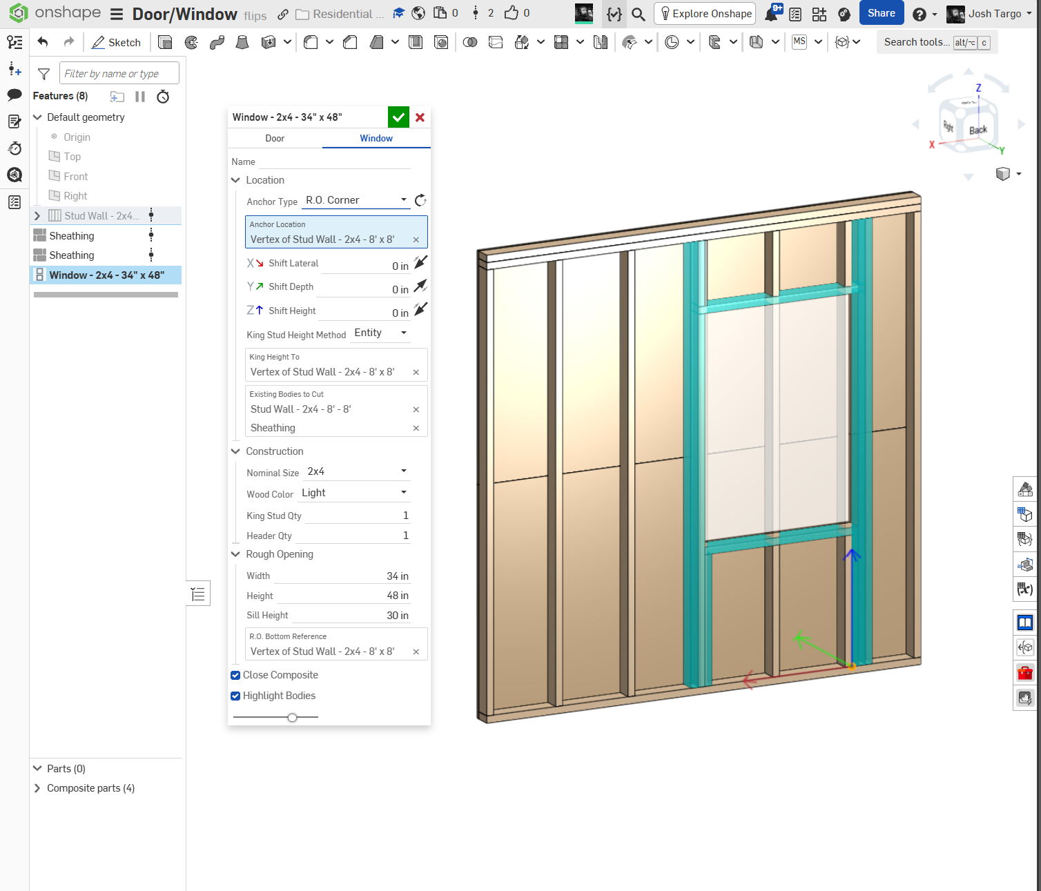

Window.fs added to my Residential Construction suite
joshtargo
edited August 5 in FeatureScript
Window inserts lumber as shown and cuts away existing Stud Wall framing and panels created with Sheathe.
Now time to update Door to work and look like Window…

    Working on big UI improvements. This is an area where AI is maybe the least help, and is one of the most important aspects of a good feature.

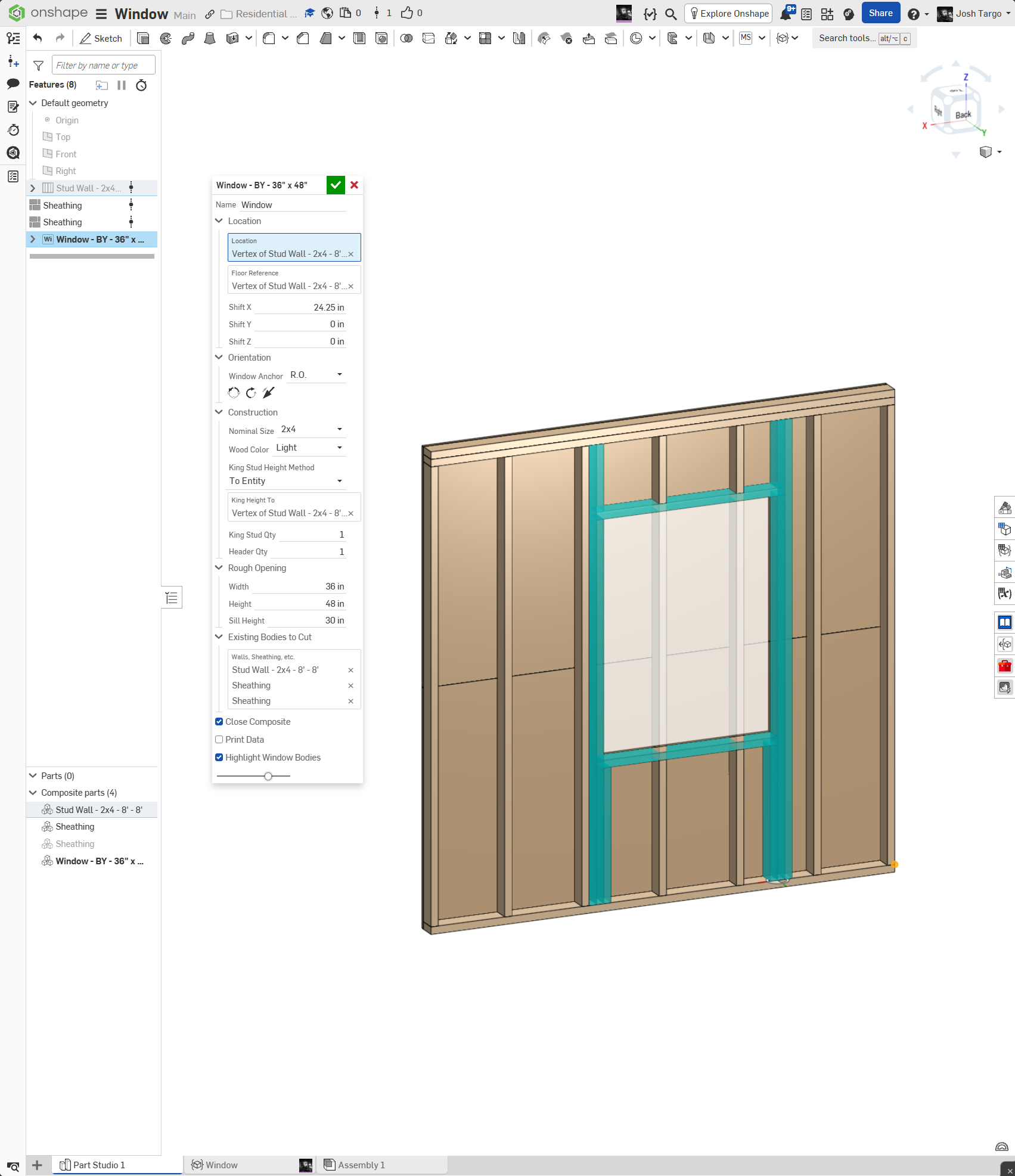

  • romeograham
    romeograham Member, csevp Posts: 783 PRO
    Do your windows and door rough openings have an option for Headers (2x 2x6, 2x8 etc depending on the span)? Then the inner most king studs become cripples. And you still need the nominal framing material above the opening (the counterpart for the sill).
    Love this!
    I want to go back and design my house stick-by-stick in Onshape instead of Sketchup like I did (back in 2005!).
  • joshtargo
    @romeograham I don't have it in there yet, but I will need options for bigger headers. Probably the typical double 2-by with 1/2" osb between. Glad someone is taking a look at all this!

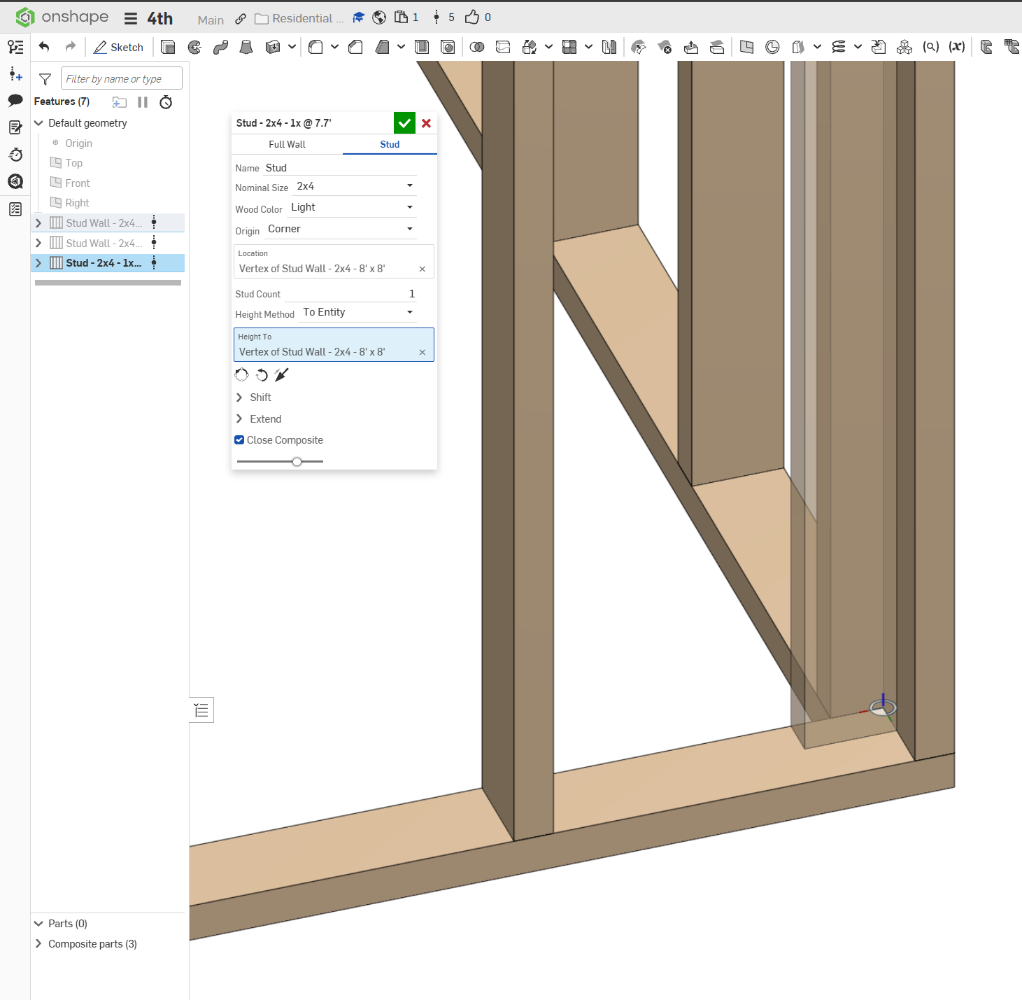

  • Derek_Van_Allen_BD
    Derek_Van_Allen_BD Member Posts: 1,167 PRO
    I've also not taken these scripts for a test drive yet but I've been curious if you've done California corners or more traditional framing.
  • joshtargo
    @Derek_Van_Allen_BD Each wall is its own entity, so it would be up to the user on how to construct each wall. And while i don't have a Cal-corner button, one mode of studwall is individual (or stacked) 2-by lumber, so someone could easily add the extra stud in the corner.
    It's been a little tricky to juggle the different features and keep them in sync. I work on one and make improvements, then need to go back and update the others to match. right now door/window is in the lead and I need to tune up studwall.
